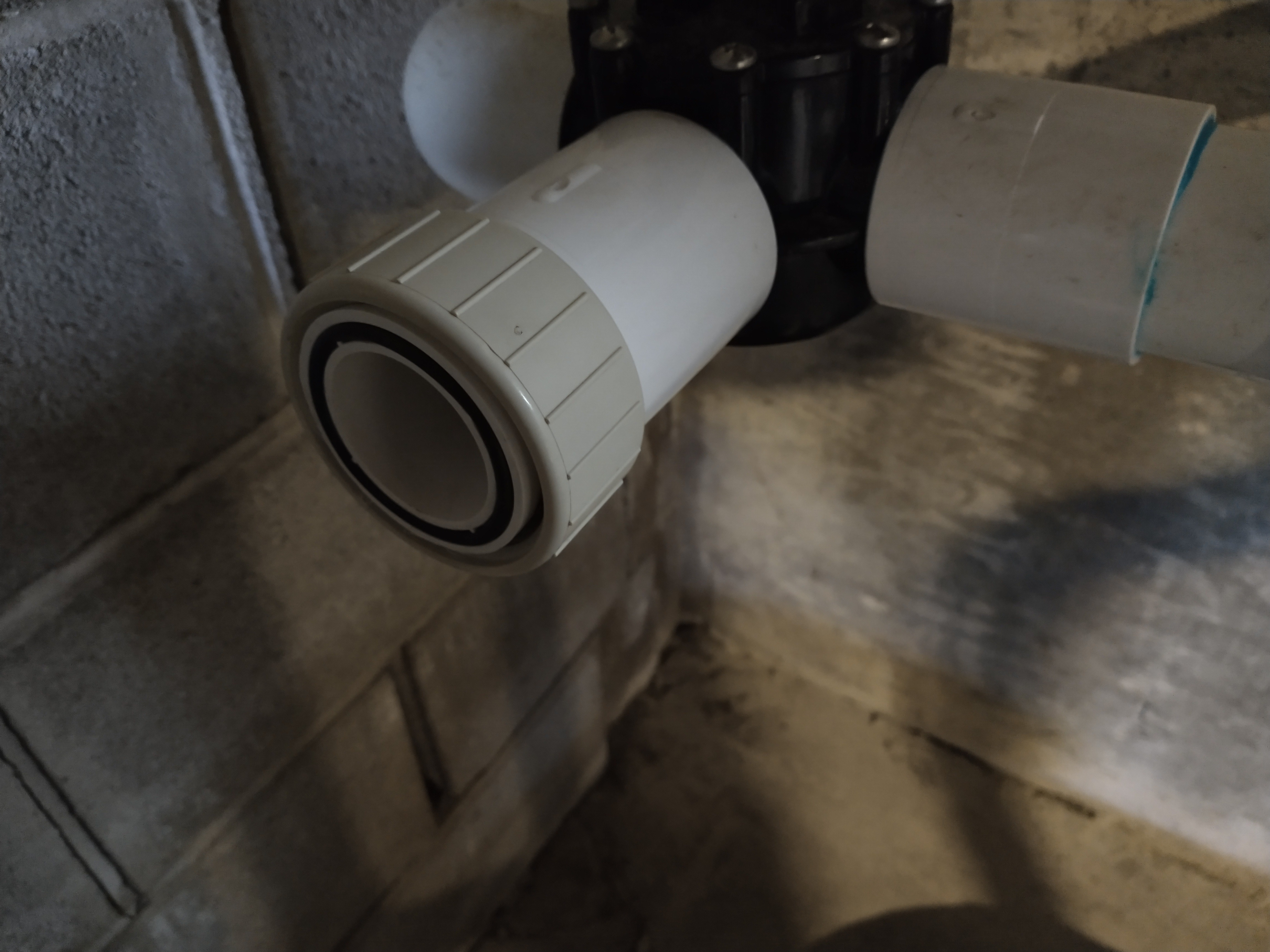

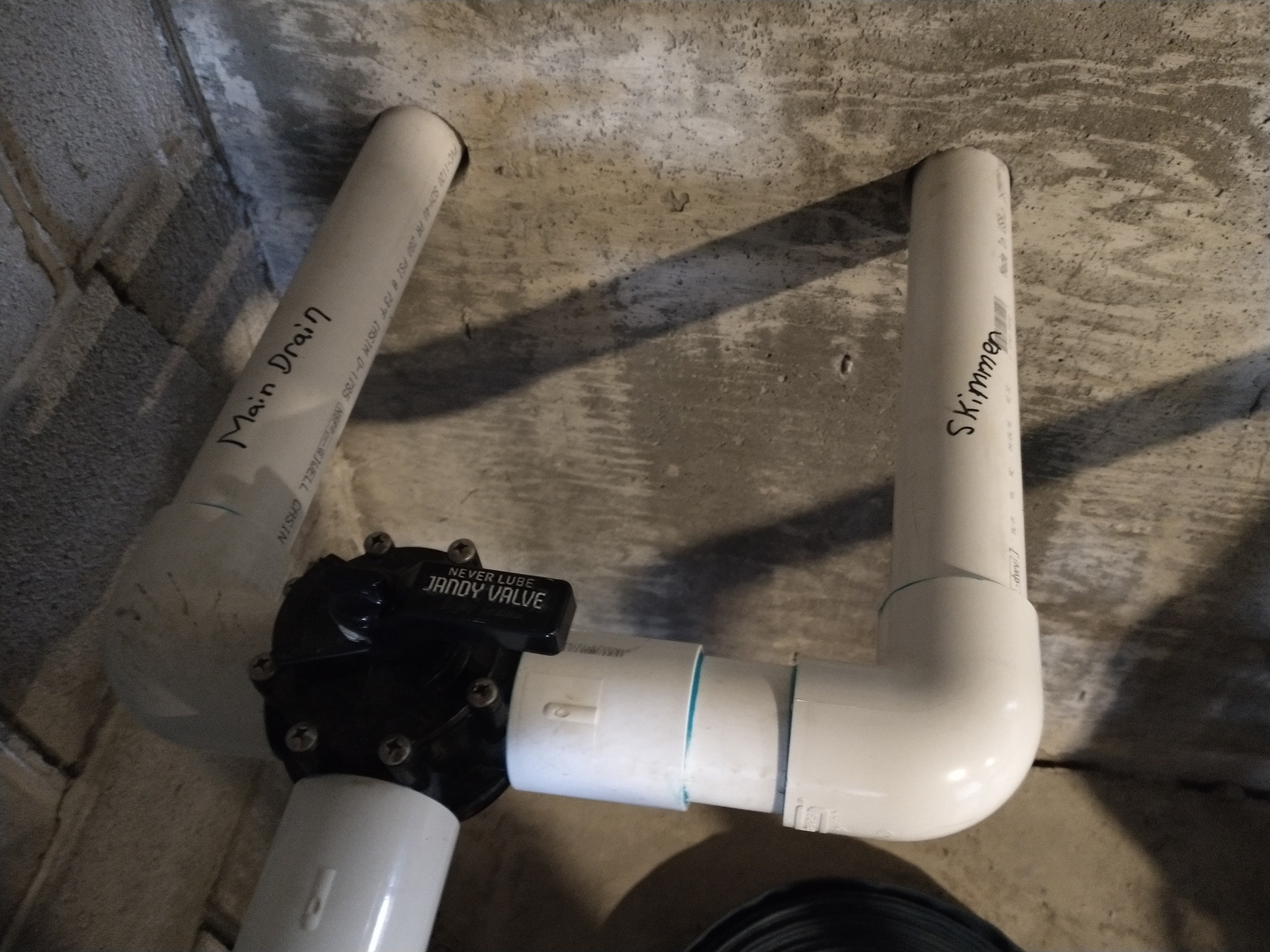

Complicating things further is that I have to blow out the drain where my pump (Pentair Superflo VST) attaches to the skimmer/drain line. Here are some pics:
As far as I can tell, the inner diameter of that pipe is 1 7/8" - it fits my vac hose perfectly… but said vac does not have what it takes.
At this point I'm open to any suggestions on how to connect to that line and reduce it down to half inch so I can use it with the compressor. Or if anyone has any other ideas I've overlooked, I'm all ears!

You can buy This on Amazon in the size you'd need for the inside of the pipe in the second picture. That will work with a compressor attachment like filling a tire. First you would blow out the main drain line till you see lots of air coming out of the main drain in the deep and then lock it off with the valve and leave it shut without moving it till next season. Next would be to blow out the skimmer in the same fashion until you have no more water coming out and then use a skimmer gizmo to seal it off. The water should be below the skimmer level for this.
