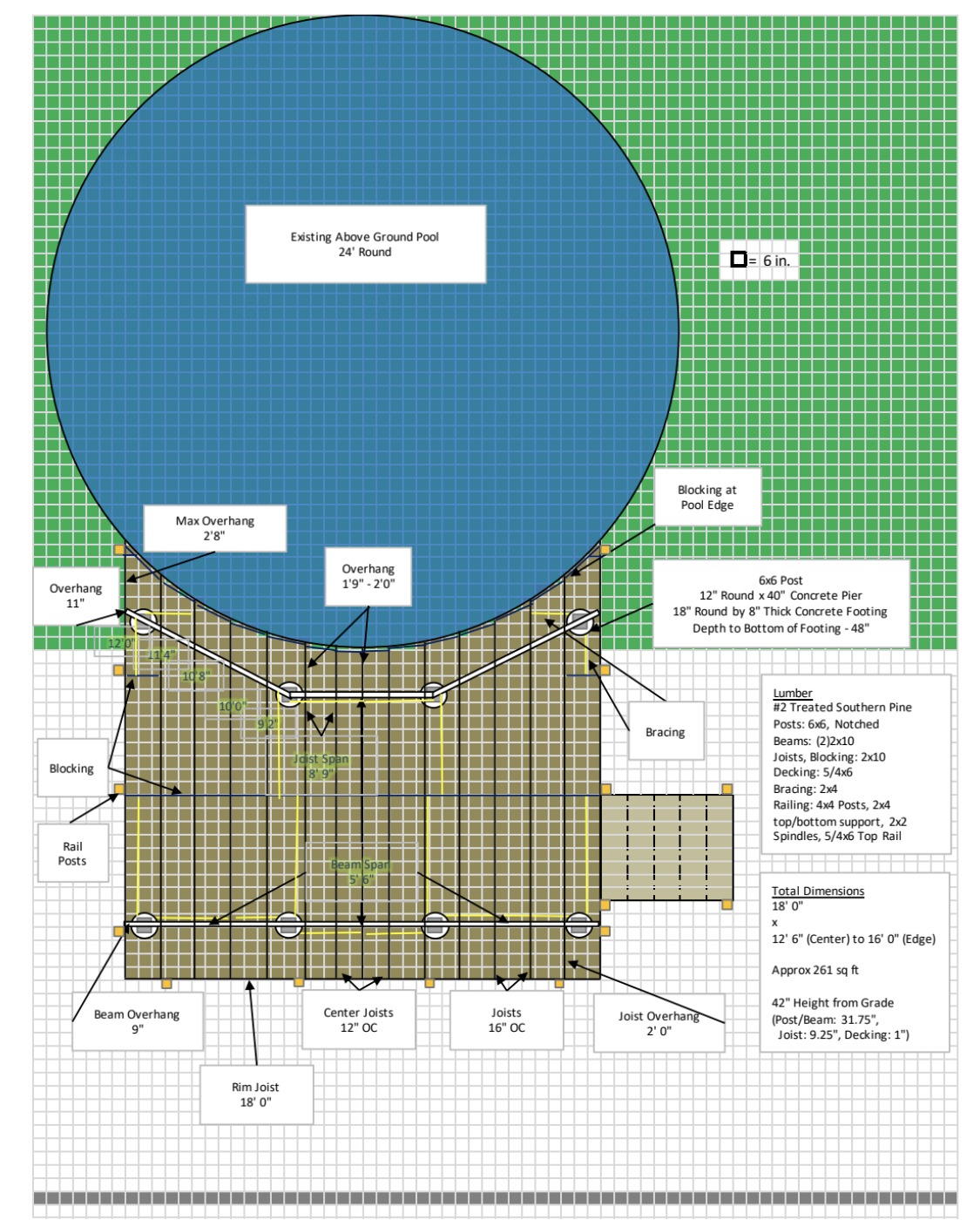

These are the plans I drew up for the deck:

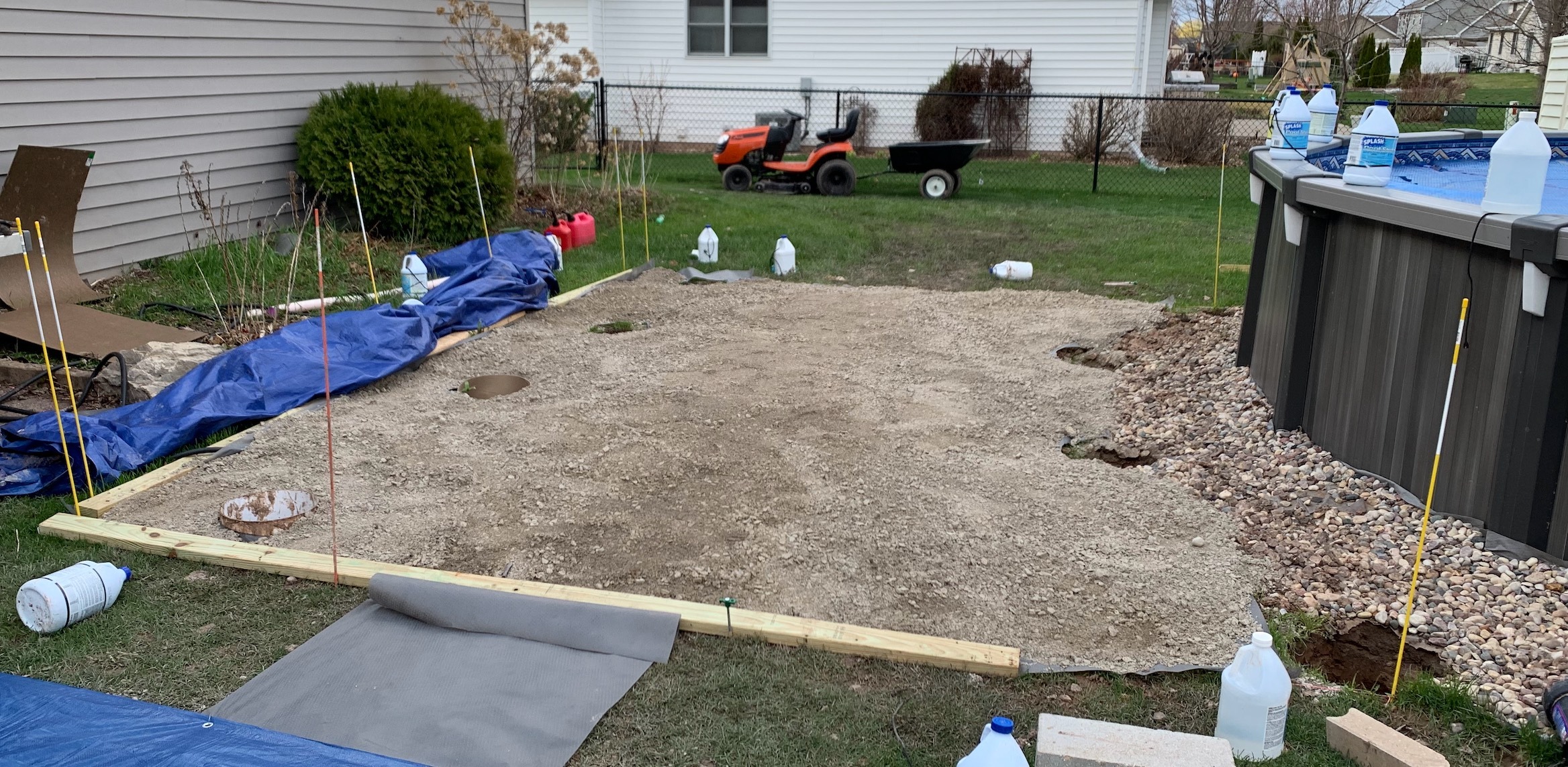

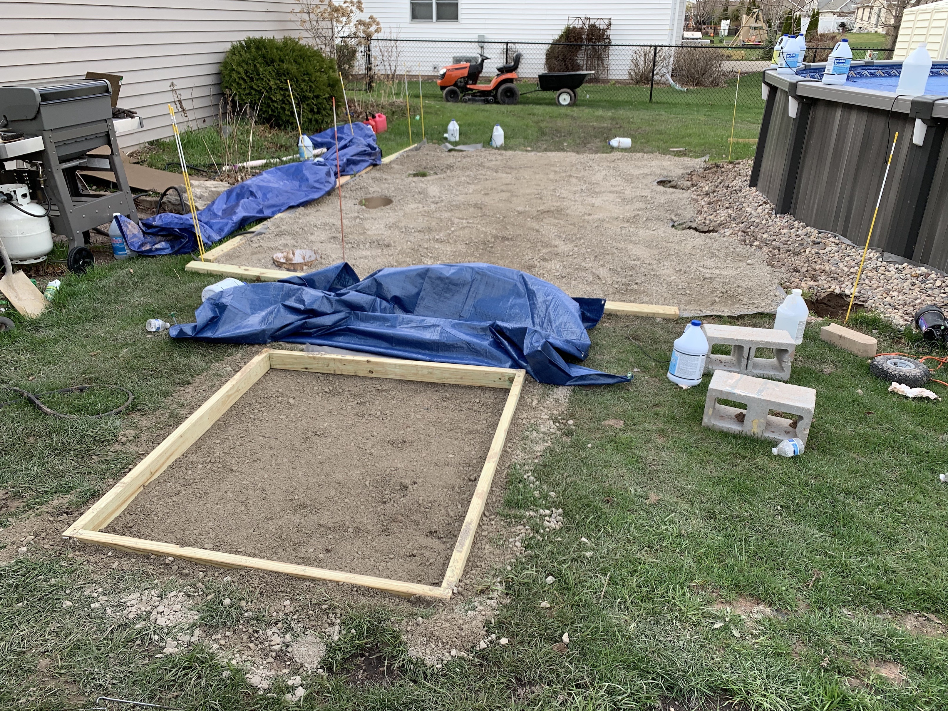

And here's the ground prep, with the footings dug. I covered the ground with crushed gravel to prevent growth underneath the deck. Once the footings are poured I have to spread and level this better, but for now at least I've got a solid surface to work on:

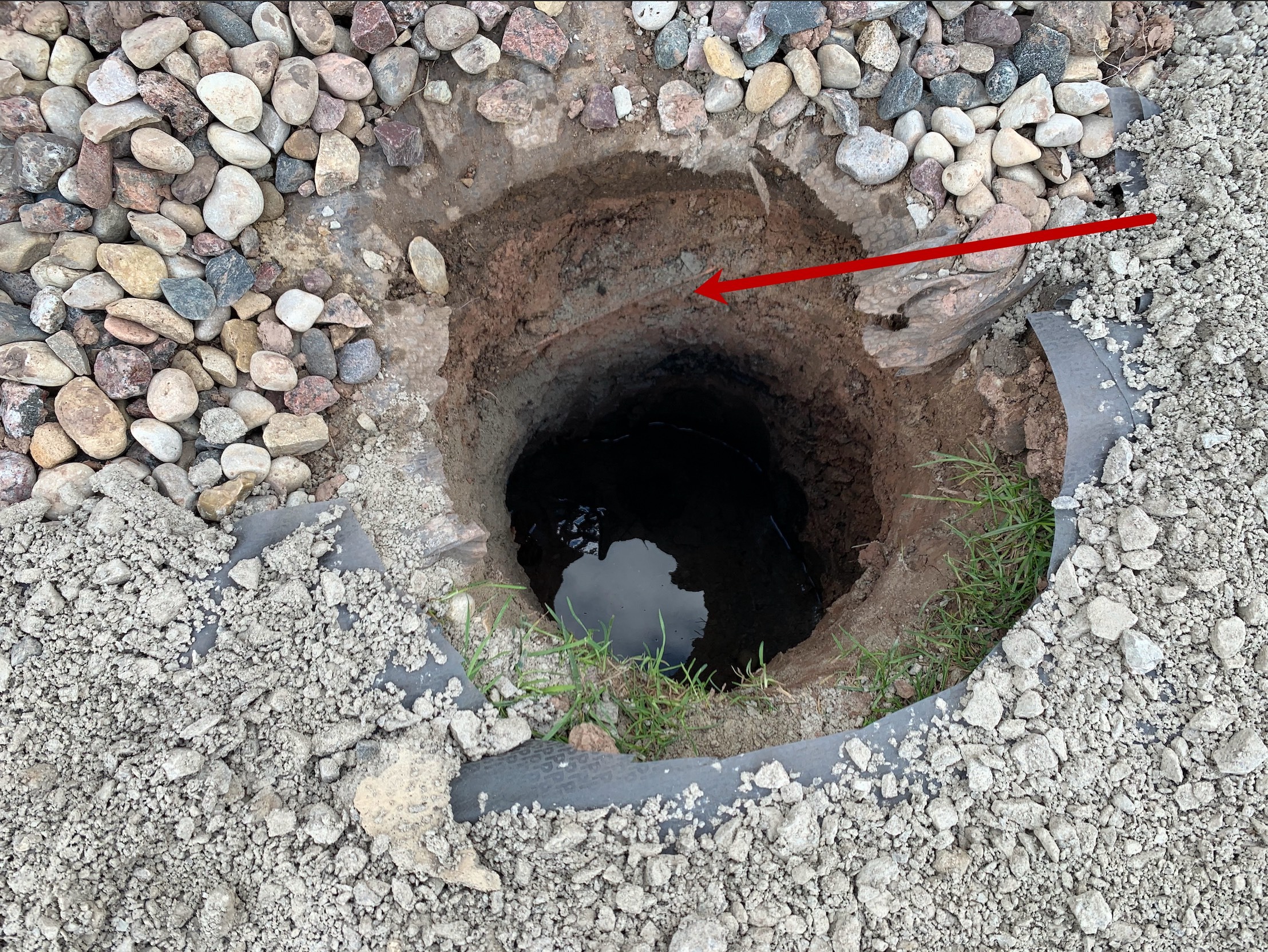

And here's one of the footings. I had to be careful digging with the four by the pool to avoid the bonding wire. This one came a little close. You can also see how much the holes love to fill with water... my little utility pump is getting a work out:
Concrete landing framed for the bottom of the deck stairs:

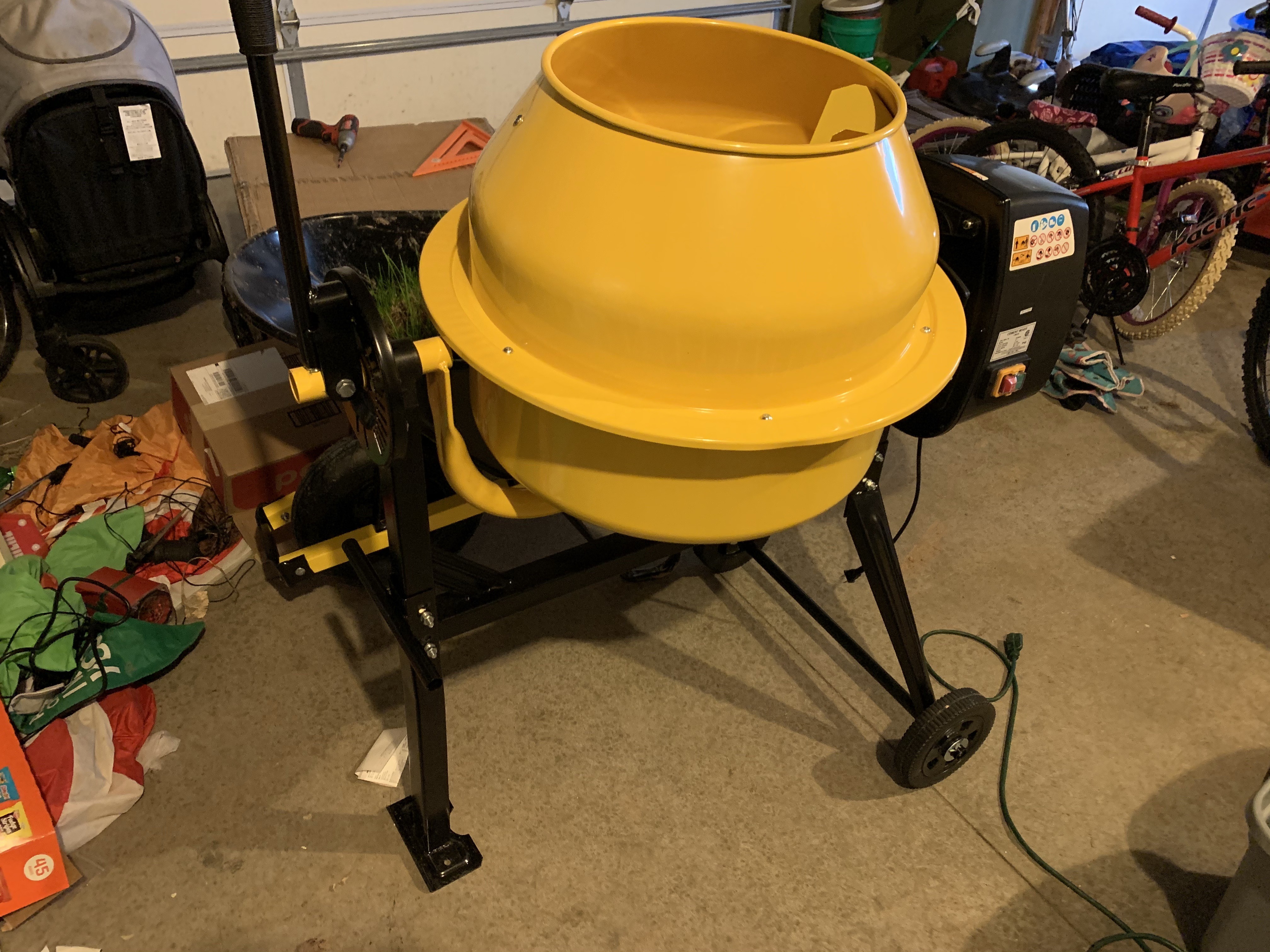

So far the weather looks to be holding up for me to do the concrete work this weekend. I wasn't happy with any of the rental options locally for a mixer, so I bought this bad boy for $300 delivered from HD. It'll get put to the test soon.

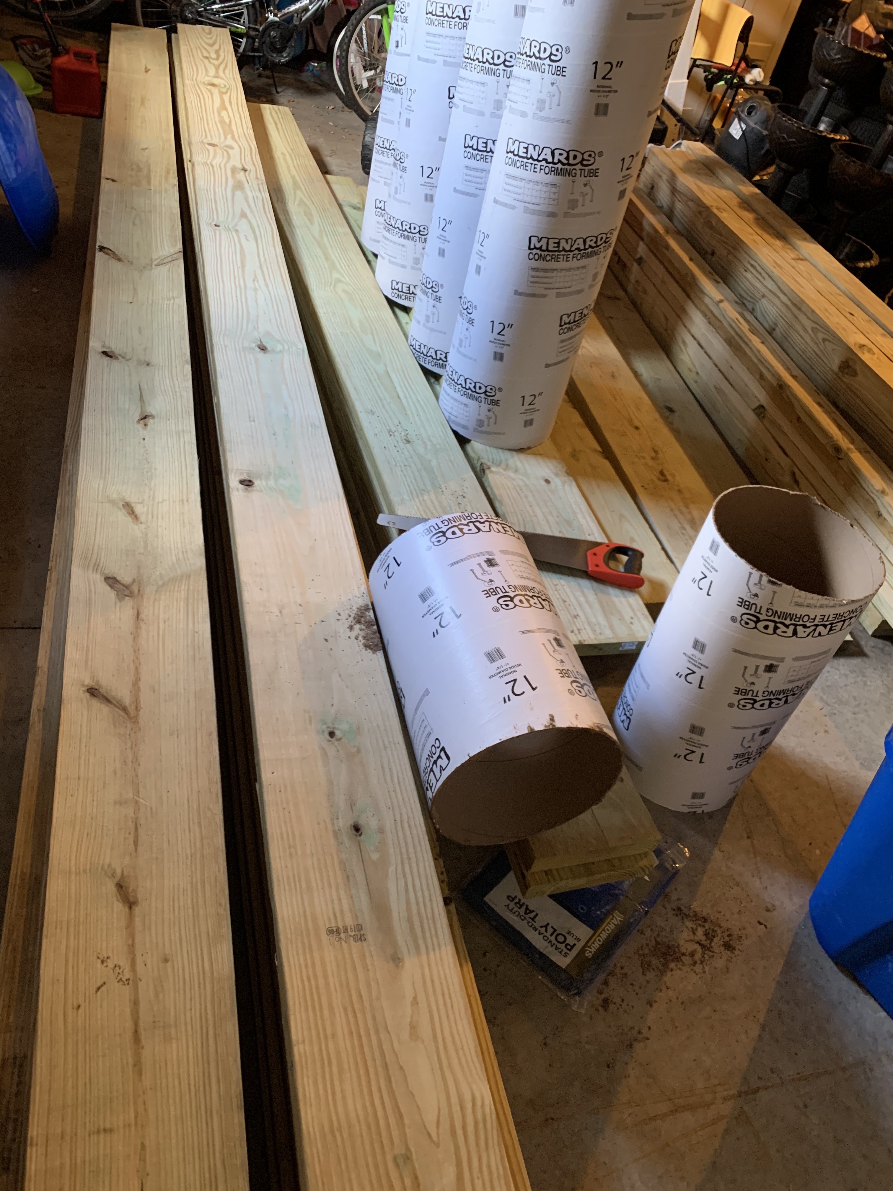

Thankful for the 3-car garage to hold all of this lumber. I haven't even bought the deck boards yet and there's so...much...wood.

Man, you’ve got some close to the surface groundwater! I live on top of the Floridan Aquifer and I have to go a lot deeper than that to get to water!

I think most of the water is surface runoff, though the clay soil is still decently wet from the spring snow melt and rains so there may be some seepage. Even with a tarp covering the area, when water starts to pool on the grass if finds whichever way it can to get underneath. And the clay retains so much water and gets so saturated that it pools a fair amount before it can soak down.

Nice. I’ll keep that in mind for any future/smaller jobs. I rented a big towable auger which dug decent enough, although the rental unit was in rough shape. I ended up using a 10-inch auger bit for my 12-inch holes. I tried a 12 but it got stuck in the clay way too easily. I think I paid like $120 for the 24 hour rental. The worst part was it dropped almost everything back into the hole, so I ended up needing a manual digger to clean it out anyway. It was an awful job and I hope to never do that again, lol.
I’ll hopefully have a concrete mixer for sale in a week or so if you’re interested. :ROFLMAO:

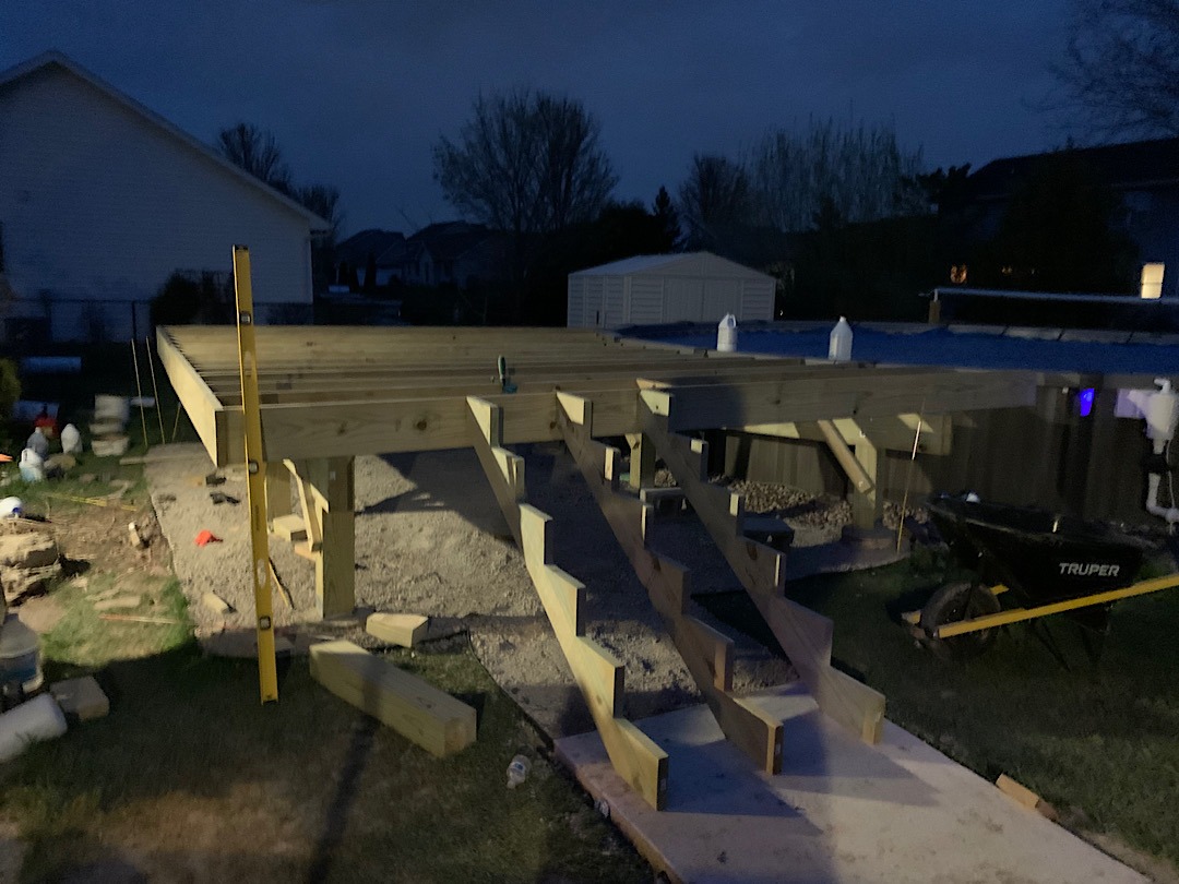

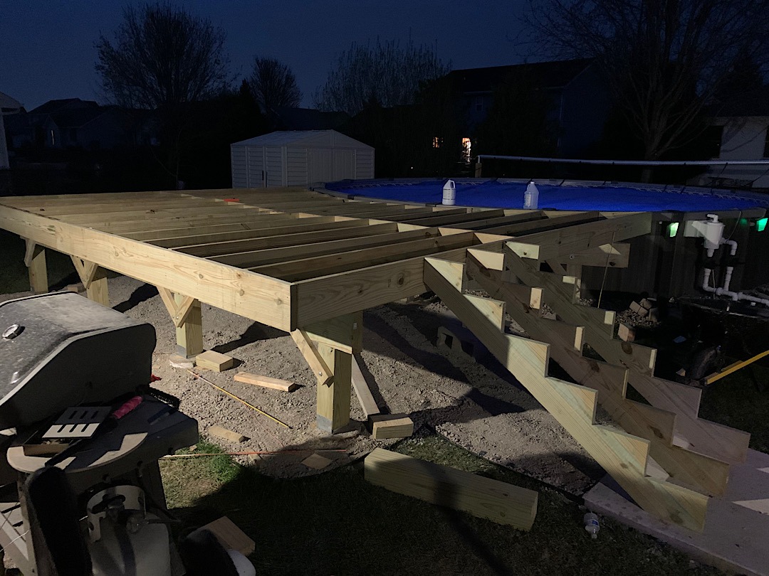

Busy weekend!
First, my $300 Concrete Mixer worked great. Took a bit to get the hang of things, but eventually fell into a rhythm and it just kept chugging along great.
Stair landing and all of the footings are poured, and I’ve got the post anchors attached and ready for the posts.
Not sure how much I’ll get done this week, but I took off the following week to hopefully get most of this thing built.

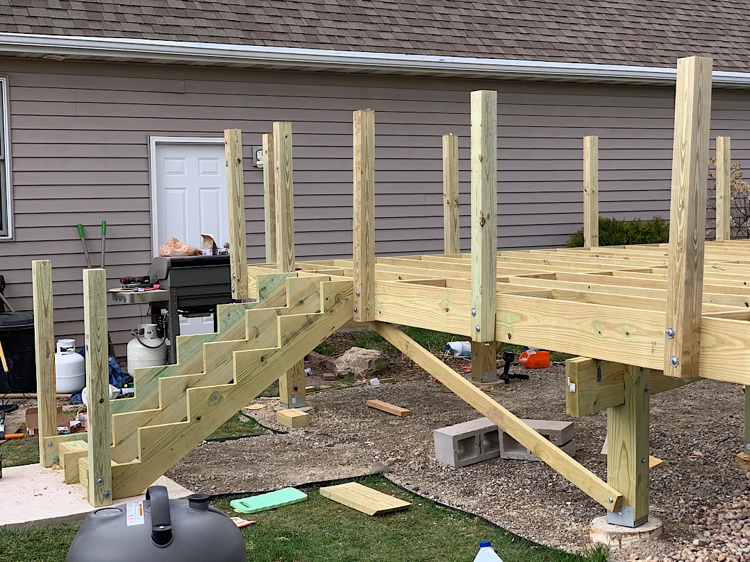

Inspection passed with flying colors. Quotes from the inspector...
"You're making my job easy!"
"It almost looks like you followed our instructions. You'd be shocked how rare that is."
"I've seen builders do much worse."
and my personal favorite...
"Would you do it by yourself again?" - to which I replied, "I told my teenage son that the next deck I build better be at his house."
