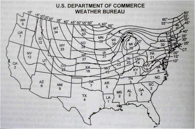

Thanks for the reply. I'm still a bit confused. I called Paramount and a very helpful tech support person there suggested that I remove and plug any nozzle heads that are above the "water freeze line;" further suggesting that I also consider spraying anti-freeze into those lines.
Question (probably dumb, so pre-facing with that :) -- what is and how do I know what is my water freeze line?
Any other tips on winterizing the Paramount system?
