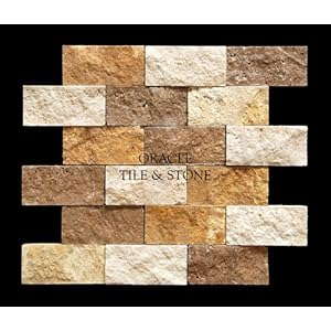

The remaining wall and columns will be covered in 2x4 split face travertine.
