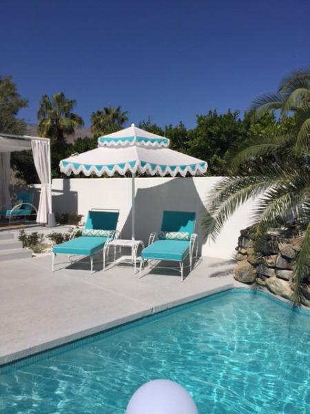

I don't particularly care for the lighter AquaBright colors. I recently did a Kona Coast pool and it looked like it was dirty before we were even done shooting it. Blue lagoon is a beautiful color especially in full sun.
I've yet to do sandstone in a pool but I feel like it might look dirty?
Blue lagoon:
AF1QipOEptgtXKISDa5VPUrPBrwi-ZhtRxc6A6M8oUyP
Blue lagoon:
Oh that looks beautiful! Would you describe Blue Lagoon as more aqua or turquoise than blue?
I agree with you about Sandstone. I'm told the water is really pretty but I don't think I'd like to see it on my bench and steps.
