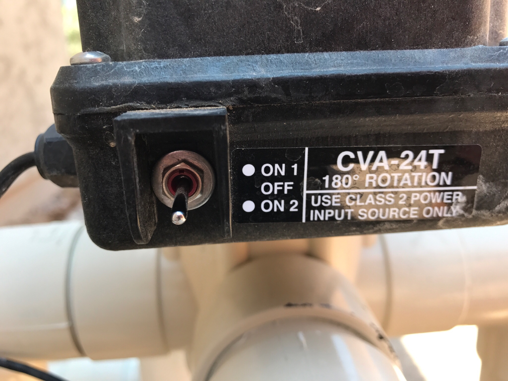

+1 to what proavia wrote. The controller is dumb, it doesn't know what position the actuators are actually in. When the pump is off it assumes all the valves are in "pool" position and all water features are "off". You have to use the 3-position switches to set the valves in this default state.
Thank you & provia!
with the switch "on 2" position it works properly. I think it was the opposite before the plumber changed it.
Okay y'all help..........what does the toggle switch do? talk to me like a girl LOL
Kim:kim:
Reference the pic above your post and the install directions in the post above mine here.
Three positions...... 1 - Off - 2
1 and 2 will move the actuator to the set limits as commanded by the automation. If the valve rotates the wrong direction, change switch from 1 to 2 or 2 to 1 as appropriate.
Off removes power to the actuator (I think)
There are 2 uses of the switch:
1) Manual override. Just like manually moving a valve handle when you are debugging, etc. When you toggle the switch (ex: from 1 to 2) it I'll move the valve to the opposite position. Toggle it back from 2 to 1 and the valve moves back. Off let's you stop the valve somewhere in between the 2 positions...while it's moving, move it to off to freeze the valve location.
2) Setting the default position of the valves. Generally you shut all ScreenLogic items to off and use the switches to put the valves in pool mode with all water features disabled. This synchronizes ScreenLogic with the valve positions.
So, you can't leave the switch in the off position when you want screenlogic/easy touch to control the valve? It seems like in my case, the switch has to be set to 2 on, in order to work properly in auto mode.
