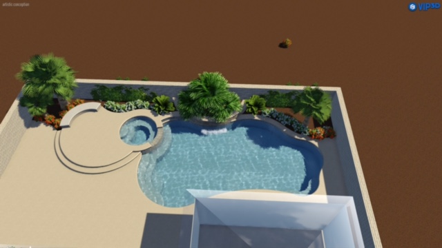

    Vegas OB! Just got plans back and need some feedback (pics included :) )
    Hi ALL!
    So first I would like to say Thank You to all the great folks here of TFP! This is a wonderful community and the folks that frequent this site have been very helpful and extremely nice. My wife and I are looking at going the OB route because I feel like I can get so much more for my money if im in control and im the one spending it ( along with kim and the great folks here lol). We have visited several PB in the Vegas area and could never come up with a price where we felt we were getting a good value from, so after talking to many folks on here and reading through hundreds of threads we decided to take the plunge and build it ourself. Special shout out to Quing guy and northwest vegas for providing tons of insight and pointing me in the right direction, also cant forget brian as he has responded to EVERY email i sent . A little about us- we have 3 kids ages 6,9,11 and we just want to build a nice pool where we can cool off in this desert heat and have a nice entertaining area. The pool we are looking at is a free form 33x17 with a raised spa and a raised planter with a water feature and adding an additional 650-700sqft of decking. I will post pics below so please dissect the build and ALL feedback is welcome. I am still new to some of the pool terminology and I have alot of questions so please bare with me as I am learning.
    Thanks for your time
    Will

    pic of the plan ( blue arrows is where lights will go, thanks brian!)
    3D of pool
    Equipment suggested (thanks brian)
    Careful, Brian has his ulterior motives
    Totally my personal opinion here but I would ditch the raised spa and just have a giant sun shelf with bubblers and make the pool more of a rectangular shape (or do some Grecian corners). Again, just my opinion but attached spas are kind of whimpy and really just places for the adults to sit. If you want therapy, you really need a separate hot tub. As for the rectangular shape, it's A LOT easier to cover a rectangular pool with a bubble cover than it is a free form pool. With evaporation rates that you get in the desert (take it from me, I live in the hottest and driest place on the planet), you will save a TON of money on water bills by being able to properly cover your pool. It also makes an eventual solar heating installation much better when you can properly cover your pool. Many people find using a bubble cover on a freeform next to impossible and then just don't bother using one. Once you uncover your pool, all that heat you can potentially build up in the cooler months (March/April and October/November) just evaporates away.
    Again, the above is personal opinion. I'm sure you'll have a wonderful space no matter what you do.
    Oh, and look into the RF EasyTouch remote. It's nice to have a piece of equipment that doesn't have to rely on WinDOHs and your wireless network being up in order to function. My remote has never had a blue-screen of death and has had 100% uptime (aside form battery changes) since the day it was installed 4 years ago... hehehehehehe....
    Matt
    16k IG PebbleTec pool, 650gal spa, spillway and waterfall, 3HP IntelliFlo VS / 1.5HP WhisperFlo, Pentair QuadDE-100 filter, IC40 SWCG, MasterTemp 400k BTU/hr NG heater, KreepyKrauly suction-side cleaner Dolphin S300i robot, EasyTouch controls, city water, K-1001, K-2006 and K-1766 test kits, Mannitol test for borates

    Re: Vegas OB! Just got plans back and need some feedback (pics included :) )
    So we kinda kicked around the idea of a sun shelf, however, we feel like we would never use it and it takes away from swim/play space especially with the backyards in vegas not being overly big ( were from so cal ) Also i dont like sitting in the sun and i already have a perfect caramel tan . Also we thought about going sloar since Vegas is sun 360 days a year but changed that as well when we committed to doing an owner build and adding a spa since we will save some $$$.
    So i do have some questions about automation since i know NOTHING about it. With the EZ touch 8 and screen logic 2 ill be able to control everything right from my phone or tablet? DO i need a load center or transformer.... im not 100% sure what these are but i have read this on other build threads. I would love for someone to explain the whole automation process to me and let me know what i truly need to control it on my phone without going over the top in equipment cost
    Thanks
    I'm sure Brian and Jim will be by soon to take me to task for trying to lead you astray I'm very much a ScreenLogic apostate as I march to the beat of a different drummer (it involves 80's music). Brian and Jim are the automation experts and they will give you the very best advice on exactly what you need.
    I'm glad you're able to go OB as it will get you so much more pool for your money. I have a raised spa and so my comments about them come from my experience of not really using it as much as I thought I would. I also have four small kids (11, 8, 4-/12 and 11 months) and I know they'd have way more fun with a sun shelf and bubblers than they currently do with the spa. But that's just my experience now, perhaps my spa will see more use in the future and I'll appreciate it more.
    Do reconsider the shape of the pool. You don't necessarily have to go to a rectangle but if you minimize the tight radii of the free form shape, then a cover is a lot easier to imagine. Believe me, evaporation has a HUGE impact on water chemistry and your wallet not to mention making a pool harder to heat. A cover is an absolute must have if you want to get your pool swimmable in the elbow months and not put yourself in the poor-house with massive gas and water bills. Just something to think about.
    Matt
    Would you be so kind as to draw out a few examples on a post it or even a old piece of garbage lol. But seriously I'm a visual person and what your saying makes sense but not sure how I could make it less curvy and still keep it as a "free form" my neighbor has a geometric pool so I don't want to be a copy cat.
    Also I tried to make my design with "soft curves" as I explained to the designer cause I wanted to maximize swim space without going rectangle
    Quote Originally Posted by JoyfulNoise View Post
    Totally my personal opinion here but I would ditch the raised spa and just have a giant sun shelf with bubblers and make the pool more of a rectangular shape (or do some Grecian corners). Again, just my opinion but attached spas are kind of whimpy and really just places for the adults to sit. If you want therapy, you really need a separate hot tub. As for the rectangular shape, it's A LOT easier to cover a rectangular pool with a bubble cover than it is a free form ...
    Jeez Matt, way to:
    Matt is correct from a simplicity and efficiency standpoint but don't let that be your total persuasion. A pool should be enjoyed and be visually pleasing. I imagine you went back and forth on several design changes and ultimately settled on this. There is nothing wrong with what you have planned.
    I love my attached spa and would not build a pool without one. If you see yourself using it then go for it but if you are doing it because everyone else has one, there is no trouble getting rid of it.
    Pentair is coming out with a new automation system that will likely have an updated wifi interface. There isn't much information out on it but being where you are at your stage of the build may be worth taking things slow.
    Matt's RF remote may be reliable but so were horses before cars were built and record players before MP3s, and hand cranks before power windows... Screenlogic will allow you to control all functions of your pool through your cell phone...Or you can carry around a giant flying saucer with horns and push buttons to do the controls for you - your call
    Well you have gone a done it! You started your pool build! SWEET!
    I love your design. It is almost as if you have done some reading on a place that knows all about pools! Lets count all the things right with it:
    -swim lane-YES
    -lights pointing away from house-YES (I do wonder about the last one on the right-will it point at the spa and spa bench too much?)
    -pleasing to the eye look-YES
    -benches for sitting and chatting-YES
    -place to put eye catching BLING-YES!
    There is NOTHING I would change! We will look at that last light and see what others think. I don't know must how bright those lights are so it may be a non-issue.
    Will there be lighting up on the spa decking? I am guessing you will have a fire pit up there with comfy seating for me to curl up in. What about lighting for the landscaping? These could all go in the system y'all come up with.
    What are you thinking for color and material? Does your wife have any ideas yet? Do you?

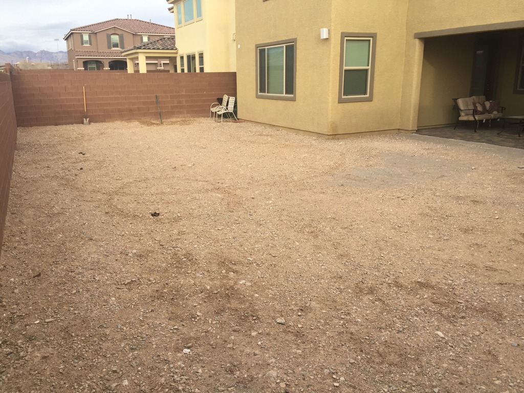

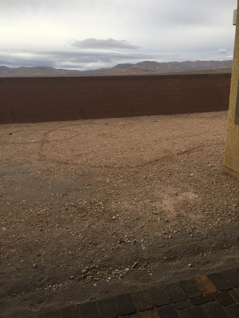

    Here are some pics of the backyard and my little pooch who snuck in one lol. Ill answer your other questions right after my meeting kim
    view from french doors
    right corner view
    left corner view
    right side where equipment will go
    left side access with my puppy ( we will do crane over from back since there will be no homes)
    patio view along with my poor drawing that me and the kids did to outline the pool lol. On a plus side the view is nice and will never be obstructed
