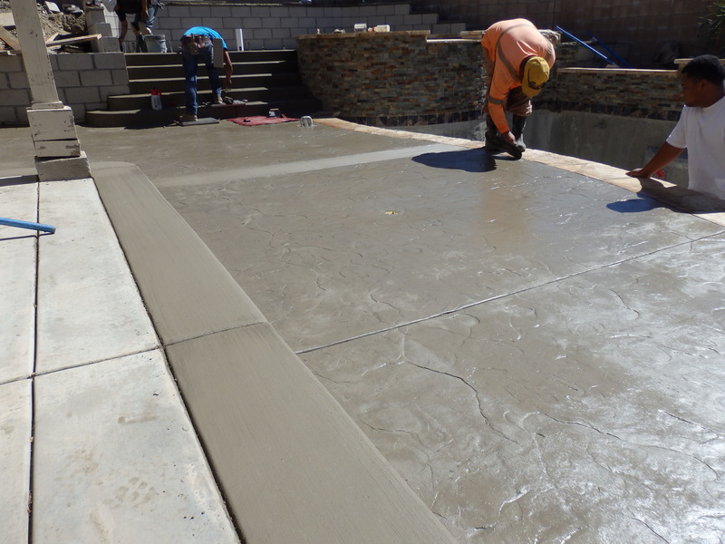

SO, the cement is done, it's drying and looking uneven at the moment due to the variable drying, but it should be walkable by Saturday, hoseable by ~Tuesday, and fully cured/color finalized by Thursday according to our cement dude. By last light tonight it is already multiple shades lighter than in the images below. The texture turned out great and really looks nice with being broken up by the few smooth cement lines. This has been 8 years in the making for our backyard. We await walking up the stairs this weekend!
The stamping was fun to watch. The pattern is pretty nice, it's funny that if you're standing straight above the cement and look straight down from the balcony, you can notice the pattern repetition... but down on the ground any way you look at it, not a thing.
The release they put on the cement to allow the stamp to not stick to it is some sort of petroleum based oil I believe... and before pouring the forms they sprayed down the wood with diesel (again for non-stick purposes)... so for the time being the backyard smells like fuel. It gave a nice sheen to the cement, made it difficult to photograph the pattern in the afternoon sun, and it has taken longer to boil off than I thought it would. Either way, it's drying :-D

By mastic, I assume you are talking about the expansion joint between the deck and coping?
If that's the case (and it looks like you did not install one), that expansion joint (or more correctly isolation joint) is a required aspect of the structural design of the pool. Concrete expands and contracts far more than most would ever think. As the concrete deck expands, it will begin to put stress on the pool shell (which expands and contracts in a completely different manner) which will cause tiles to pop off, coping to come loose, or worst case, the bond beam to crack.
While the "mastic" used in this area is really for nothing more than to dress up an otherwise ugly expansion joint, the joint itself is absolutely required as a safeguard to isolate the pool shell from any other potential forces that may arise.
You may never have any issues by not having this expansion joint but I don't want others to read this thread and then also opt out of its installation. Take a look at your standard engineering detail attached to your pool plan, it is clearly shown there and it's something your pool builder should have absolutely insisted on installing.
Re: New Pool IG - Inland Empire, CA - Decking Poured 10/6!
One more note about that. It isn't just about clay soils. While clay soil can exacerbate movement of the deck thermal expansion and contraction alone is enough to cause fairly significant movement of the concrete. Especially when the concrete is bordered on both sides by relatively immovable objects, pool and house. It would be less important if the pool deck was bordered by yard on the other side.
Anyway, as you say, keep us updated on how it goes over time. Nice pool! I like all the steps.

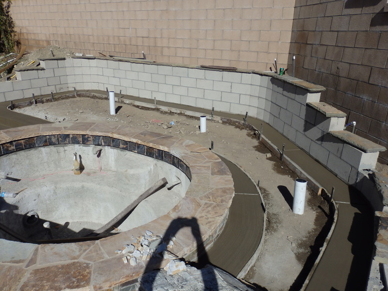

Able to walk on the cement now, no dirt, which is nice. We had some things done today and should be finished by the week with this phase of cement work. Tomorrow is a break and things will continue on Wednesday. Scratchcoat was put onto the wall, the flagstone work was started, and the perimeter wall hole is being rebuilt.
While the pieces might be small, we're using the left over coping as flagstone in the upper deck (we have it, might as well use it!). There are some larger pieces and those will be used in the larger space (next photo).
The cats were exploring the yard. You can see the scratchcoat in place on the wall, tomorrow we'll line up the caps exactly where we want them and then the wall can be completed and stuccoed. The larger pieces of flagstone will go around up there on the patio... it'll be a nice spot to put a small table and a couple chairs... current thought on the name for the raised patio is the Lido Deck.
No pic of the wall, but the base was layed down, now just need to stack it up 5ft! What's nice is, once the perimeter wall is rebuilt, we can get the inspection going and get the electrical/plumbing work done and then the plaster. Finally get our PB out of our hair!

Perimeter wall going up-
It is being built without reinforcement because in a few months we'll be bringing it down again to bring in a bobcat to finish the last 1/3rd of the yard (then we'll fully rebuild it). Just the way things worked out, time, cash, and practical wise.

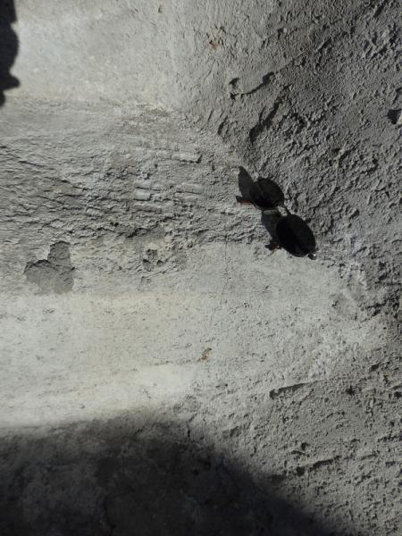

Now then, it may be nothing, as I've heard it's normal, but this morning, we noticed that there are CRACKS in the gunite!-
This crack dissipates into the side of the deep end, sweeps around up the slope of the pool and into the two lower steps where is ends.
Here it is up the step.
The second crack is a bit higher up on the pool slope and does a swooping downward, it is not as prominent as the other crack.
Here's a rough diagram on where they are (1st crack is the long one). Their position and nature indicate to me it's the pool's deep end is pulling down the shallow end, the scalloped nature suggest vertical and horizontal movement lengthwise along the pool. That suggests actual movement, but, being these are not 'big' cracks, they could be related to simple shrinkage of the gunite and pulling of the slope from the deep end and the shallow end (cracking along the rise of the slope)...
Now then... I've heard that cracks are normal... it seems these have popped up recently though as we never noticed it during curing (bonding with) of the pool. Our stone guy said he has seen it before and says it's not an issue from what he knows... personally, I've heard that cracks form (though earlier in the process, this gunite was shot 10.5 weeks ago) and aren't an issue... but, a peace of mind would be nice. What do you guys think? I've heard that if we can't put a 'sharpened pencil' into it, then it's not a 'crack'.
So, even though I'm rather confident myself... what do y'all have to say?
Re: New Pool IG - Inland Empire, CA - CRACKS in shell!
OH SO NORMAL!!!!!!!!! Did you hear that? LOL Yes it IS normal. As far as I know just about every shell develops cracks. Some worse than others but no real problems. The plaster will fill it in!
