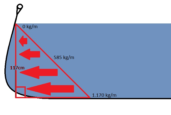

Earlier someone asked how i did my calculation. When i run the numbers again i could see that i did an error. The weight of the water will be as a triangle with the base same as the water depth.
I had to do the calculations using the metric system that i am familliar to. The result was 550lb on each pole on the metal frame. (Everey legg having 2 poles)
Maybe I have a 40 years chrisis or I'm just stubborn. But I will go at it again. This time much more slowly. After I'm done with the calculations and build I will fill the pool 1/3 and use one day of checking everything. Then I will fill to 2/3 and check. There will be a lot of reinforcement because of my mistake not counting on the momentum forces that was twisting the structure.

I like the calcs. We are on the same page here. My remaining concern is a continuous top cord. that has the effect of transferring those outward forces throughout the structure. in effect the mass of the water in the pool by its outward force around the entire pool structure stabilizes the pool. The top cord is even more important in distributing the dynamic forces so any one location does not take the full brunt of the dynamic force.
Ok so long since I calculated without computer. Does this seam right? I'm thinking that the water missing on the outside of the liner is what my frame has to compensate for. Like this, if I digg the pool down in the ground, there will be no force on the frame at all. Someone out there that could verify my calculations?
Sent from my SM-N9005 using Tapatalk
1188 kg = 2619 Punds and that is for the whole beam. Originally the shortside is lifted by 3 legs, two poles on each legg gives 6 holes in the liner plus the corners. So I will have a total of 8 bults to carry this weight. 2619 / 8 = 327 lb/bult .
