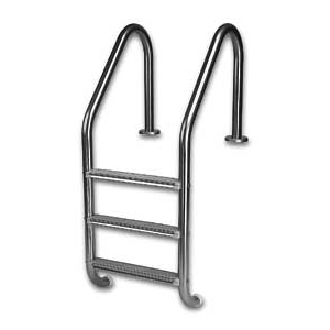

    Is there a trick to this for inground pools? I can't seem to get mine out.
  2. Back To Top    #2
    i'm assuming it's a conventional type ladder with the ends top that curl back behind the ladder and it anchors into a pool deck. if so, mine is a concrete deck that the ends go into. to remove it, i always have to wiggle it side to side as i pull up on the sides. i haven't tried it, but i imagine to make it easier to remove, putting some liquid dish soap into the space around where the ends go into the ground would make it slippier and easier to remove. mine looks like this basically.. on the top ends that go into the ground i have no flanges..just straight tube that goes into 2 holes that are about 4 inches deep in the concrete:

    That looks like mine. I've tried the wiggling. Next time i'll try the soap. I thought there may be some trick to it.
    Thanks for your reply

    There is a little more to removing mine. Under the stailess steel covers/flanges are bolts that must be loosened. These bolts tighten a wedge upagainst the the part of the ladder that is below ground. I loosen the bolts, tap them down and the ladder slides right out with no wiggling.
    Hope this helps
