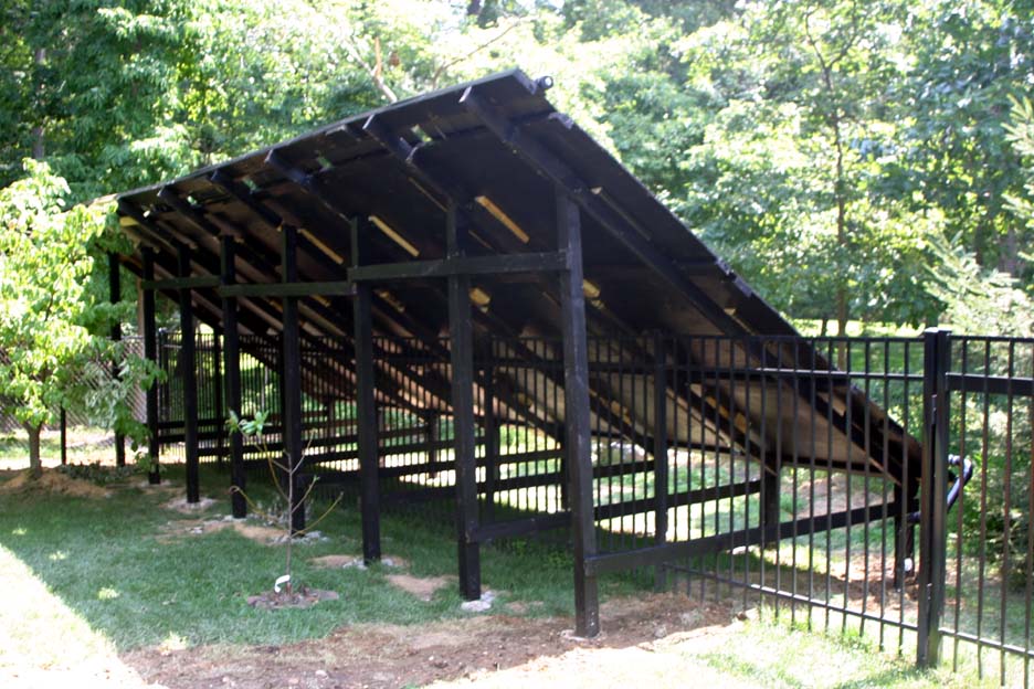

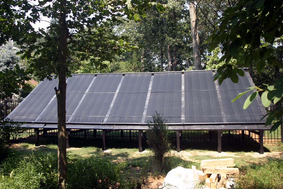

Hey guys. Its that time of year again. Im getting started on my solar panel install.
Purchased the Goldline/Hayward solar controller.
I plan on putting up the panels in a similar fashion to the pictures below. Due to my yard layout though, I am going to have two sets of panels. I'm going to run a 2" out to the panels then split out to 1 1/2" to each bank of panels. Not sure on the vacuum breaker for this type of setup though.

I typically get a 9 month swim season with solar heat and covering the pool with a solar cover in the spring and fall, the cover is coming off for the summer after his weekend. The last swim of the year is usually early to mid November, considering how busy the holiday season always seems to be, this is not such a bad thing for us. This year with the warm winter the pool was back up to swim temperatures by mid Feb.
A little Pythagorean theorem to make sure my frame is square. Going to build the first rack complete, then see where the sun is at on the shaded side to ensure I get 100% of the suns rays on both racks.
finished setting the first set of posts for the first rack.......going to use a laser level to get a good reading then chop the top of all of em to make them even.
