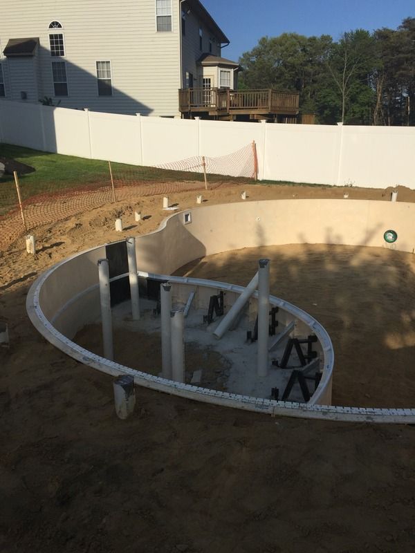

Today is backfill today. Only took two weeks, in perfect weather.
Do all pool companies take random days off to do other jobs? Its infuriating b/c those are the exact amount of days we needed to be able to make the Memorial Day date that was originally promised.

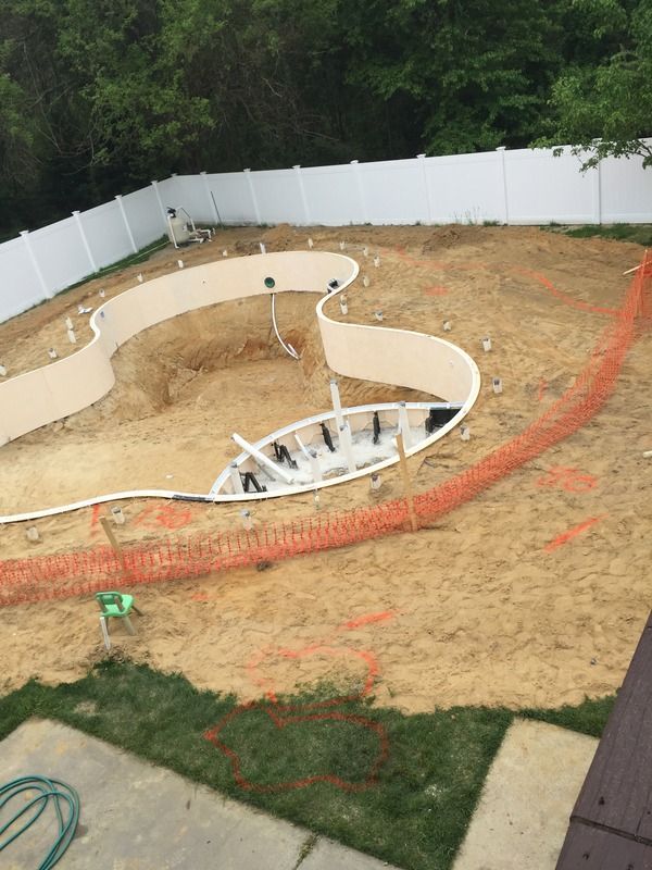

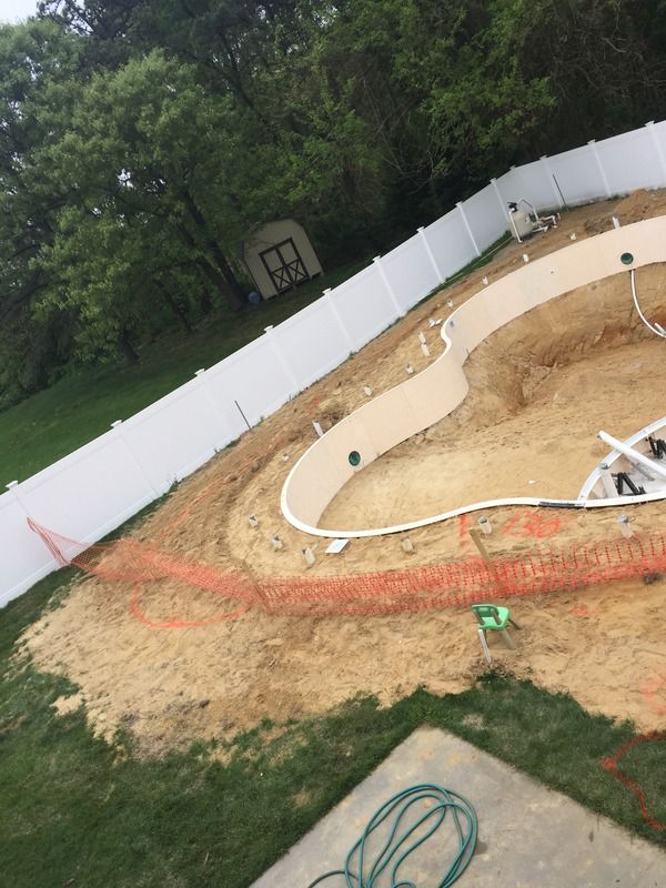

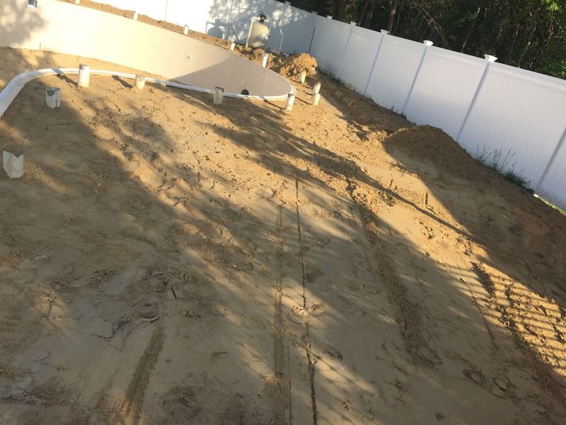

So here are some pictures from Friday, when they finished the backfill...
Saturday, Russ came by for the stamped concrete layout and painted the area where the concrete is going with spray paint. We added a little, made the minimum 4 feet and here we are:
Today they finished compacting the dirt and adding the rocks to the tanning ledge and the bench. The electrician came out. 231' of electric/over 100 feet its $7/foot - woo hoo, more money.
