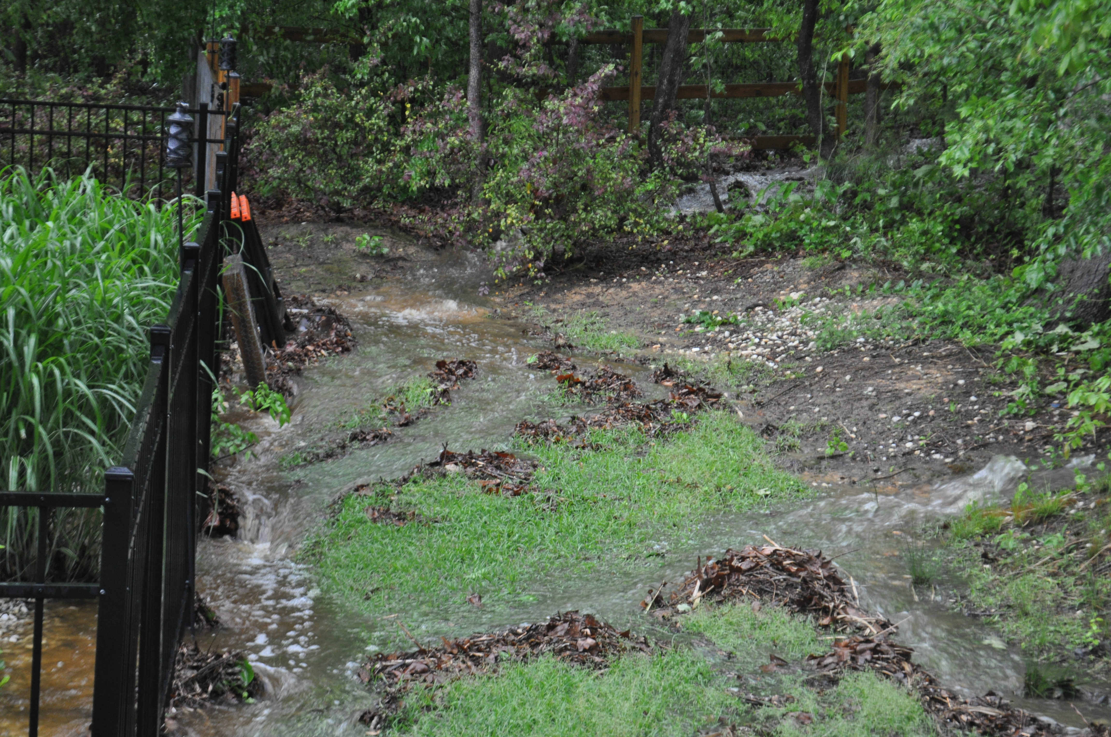

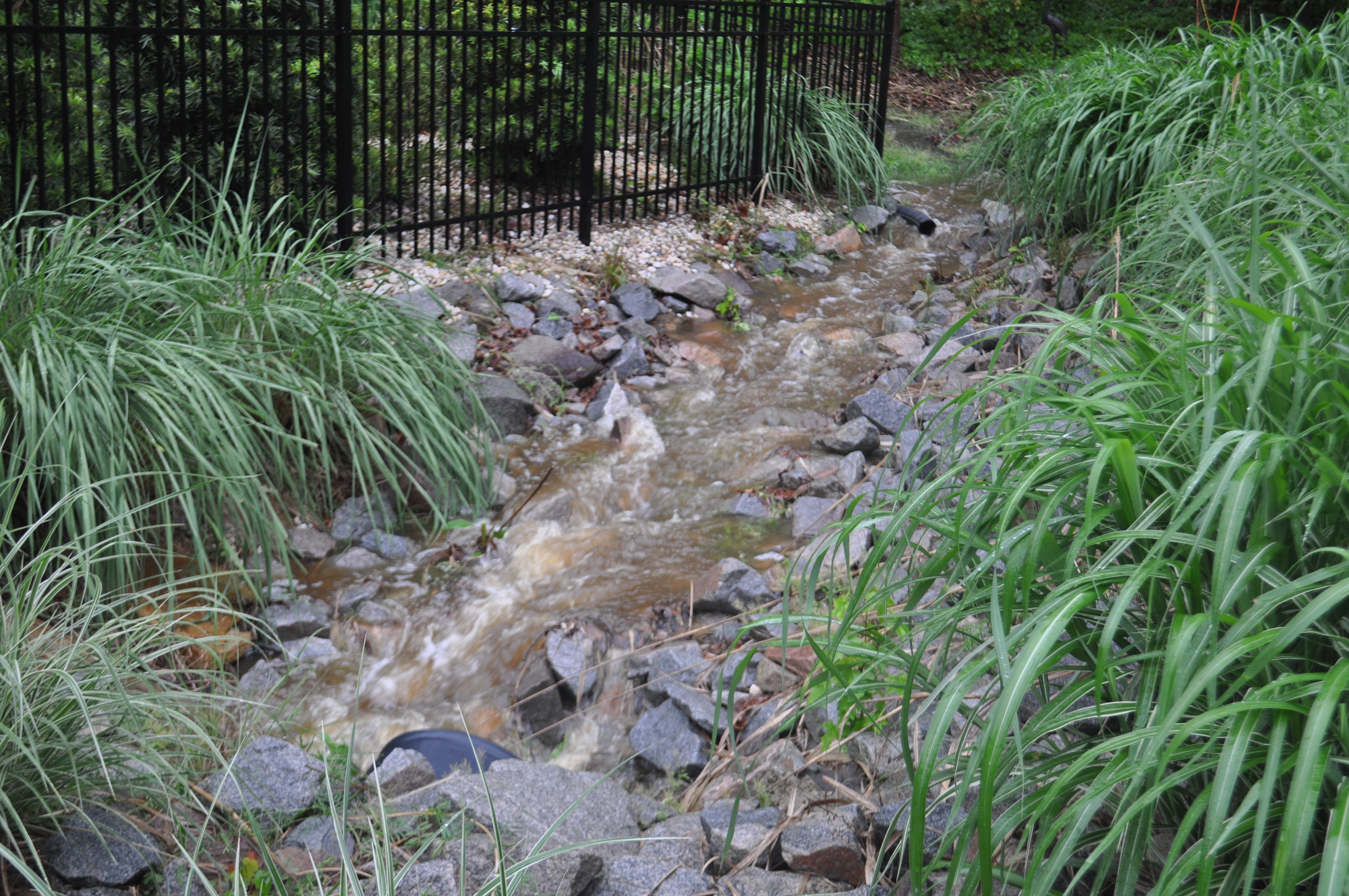

    As others have said, keep up the SLAM! It seems you sent the rain this way. Here are a couple of photos of the area around my pool yesterday afternoon. The black fence in the photos is the pool fencing.
    Behind pool. This is normally dry grass.
    The is along side the pool. This area is normally a dry reiverbed which was installed for just such rain events. It has a 24" culvert in it to drain the water to the street where it drains to the lake.
    I got a lot of runoff from the pool deck into the pool during this rain. Between the rain and runoff I had to drain water off the pool twice as it was just below the coping.

    That's a sweet river bed n run off system Tim!

    Thanks!
    As I have said in other posts, we are the low lot in our neighborhood. Heavy rain events send us water, but the is the most I have seen. While I may object to some things the previous owner (builder of the house) did, he did the best job he could in grading and preparing for water. The neighbors told me that before building the lot had a 6 - 8 foot deep ditch running through it. When they built they put the 24" culvert pipe in this ditch and covered it with gravel and dirt. As a matter of fact it is this gravel around the pipe that "I think" gets the backwash from the pool. My backwash pipe goes underground in this direction, but I have never seen any water.
