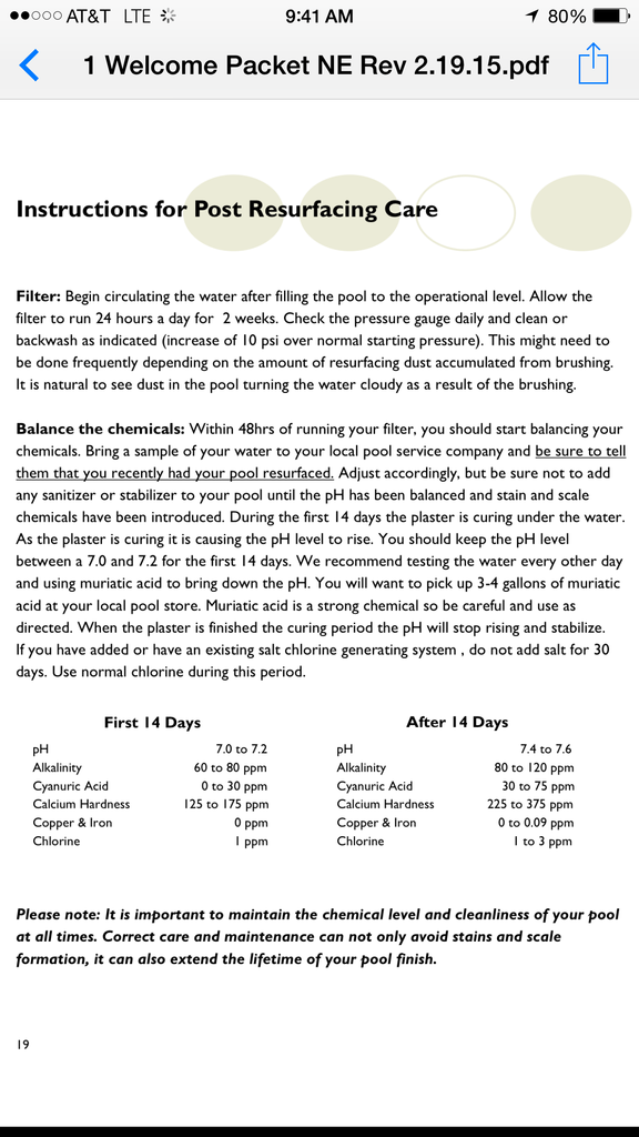

Are you planning on asking your PB if YOUR test will count for his warranty. I notice that he says "pool store test". I just wanted to throw this out there so you do not mess up the warranty. Better safe than sorry.

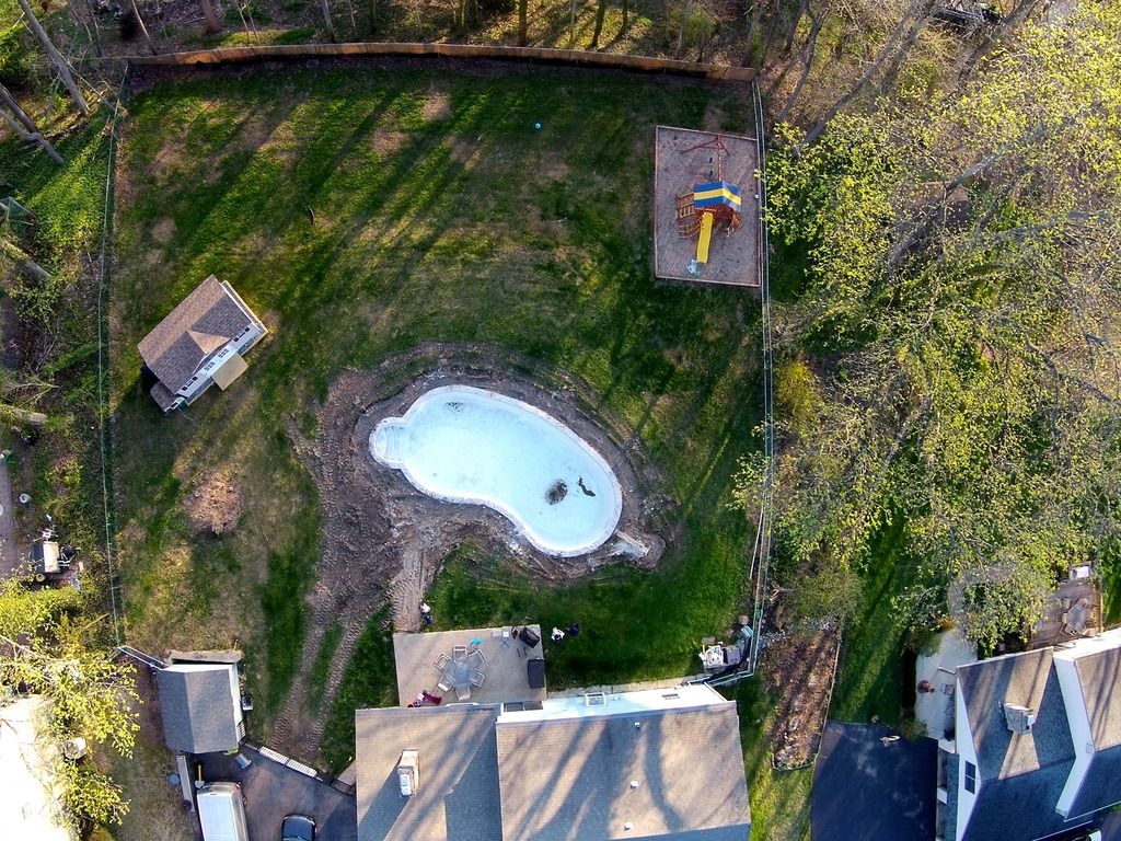

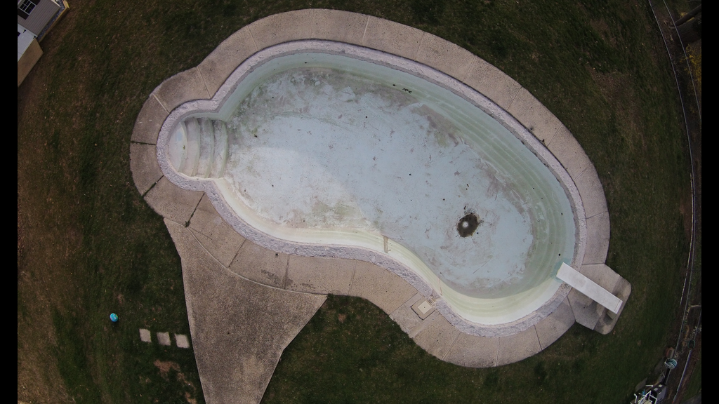

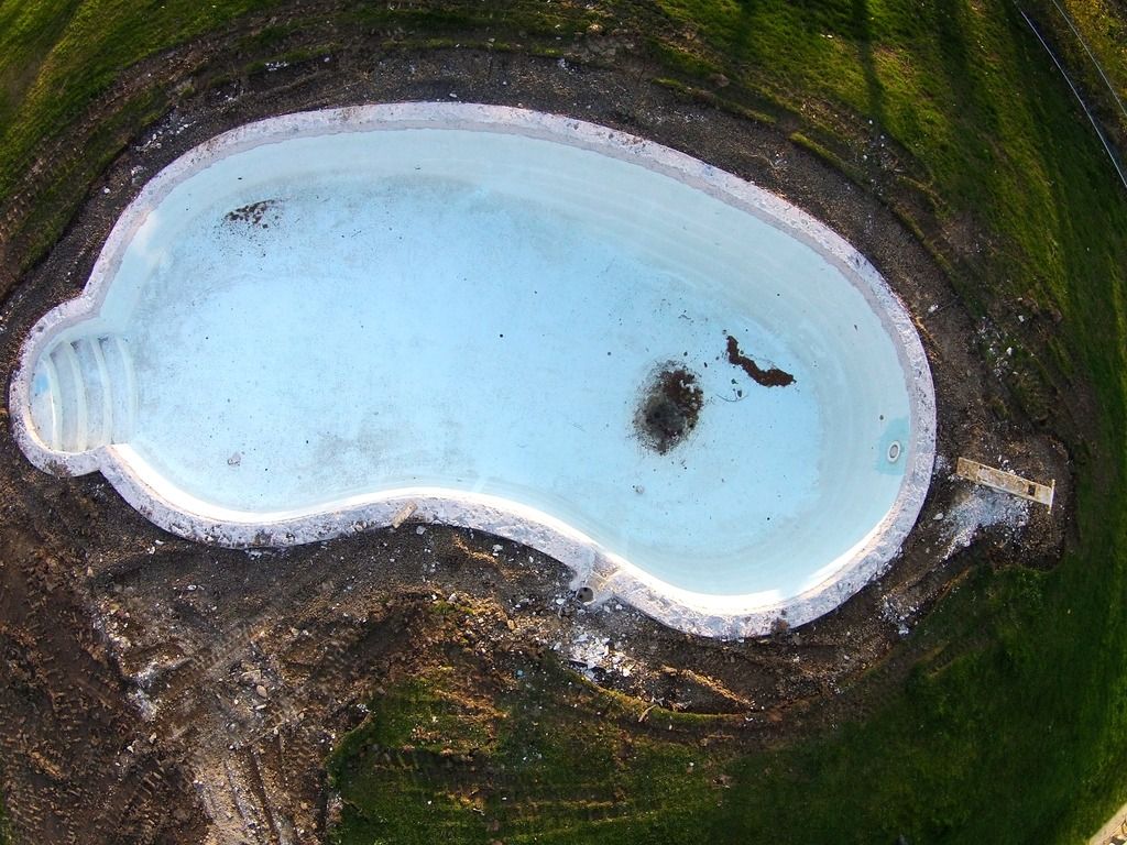

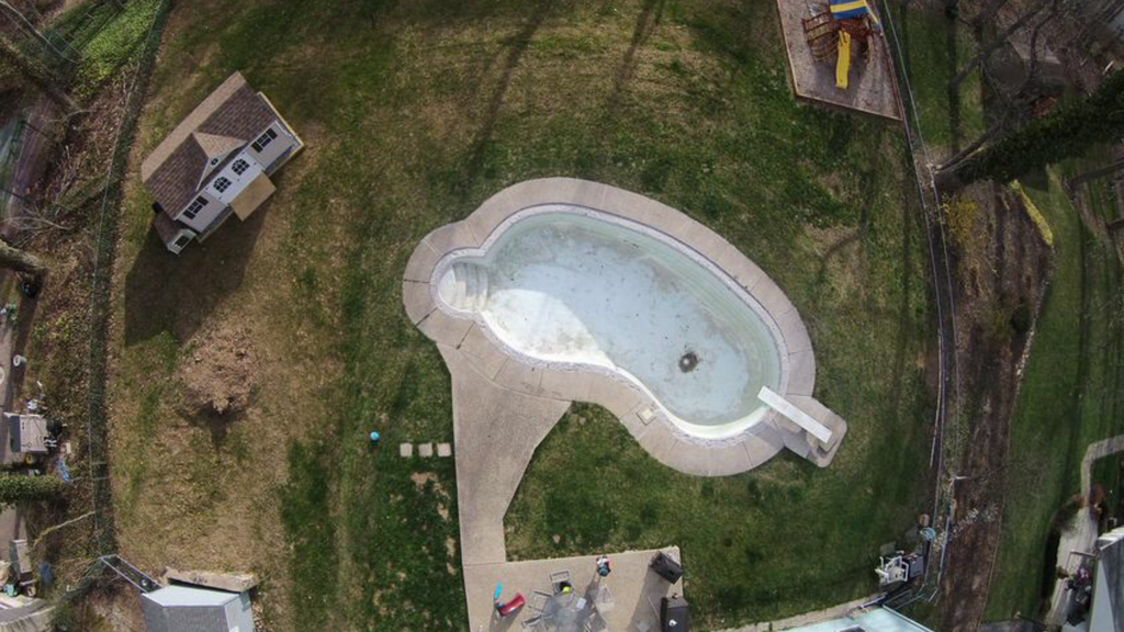

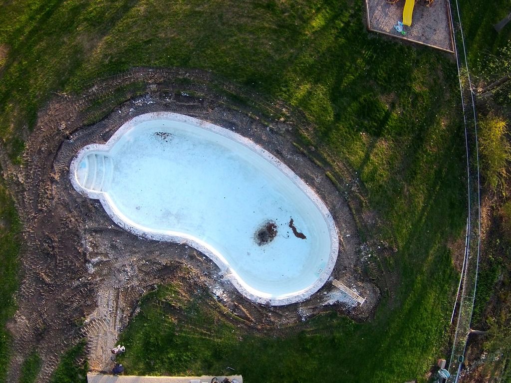

35 feet up...
65 feet up....
100 feet up...
Pool is drained, tile and coping removed. They are due back wednesday to remove decking.

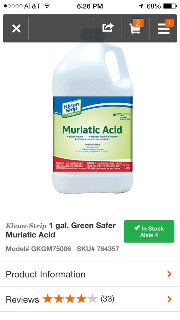

Is this a good muriatic acid to use they sell at home depot...
That acid is the half strength stuff. Costs the same as the full strength stuff, but is less effective since it is diluted. They should also carry the full strength stuff. It will say 31.45%. If they don't have it, check a hardware store.

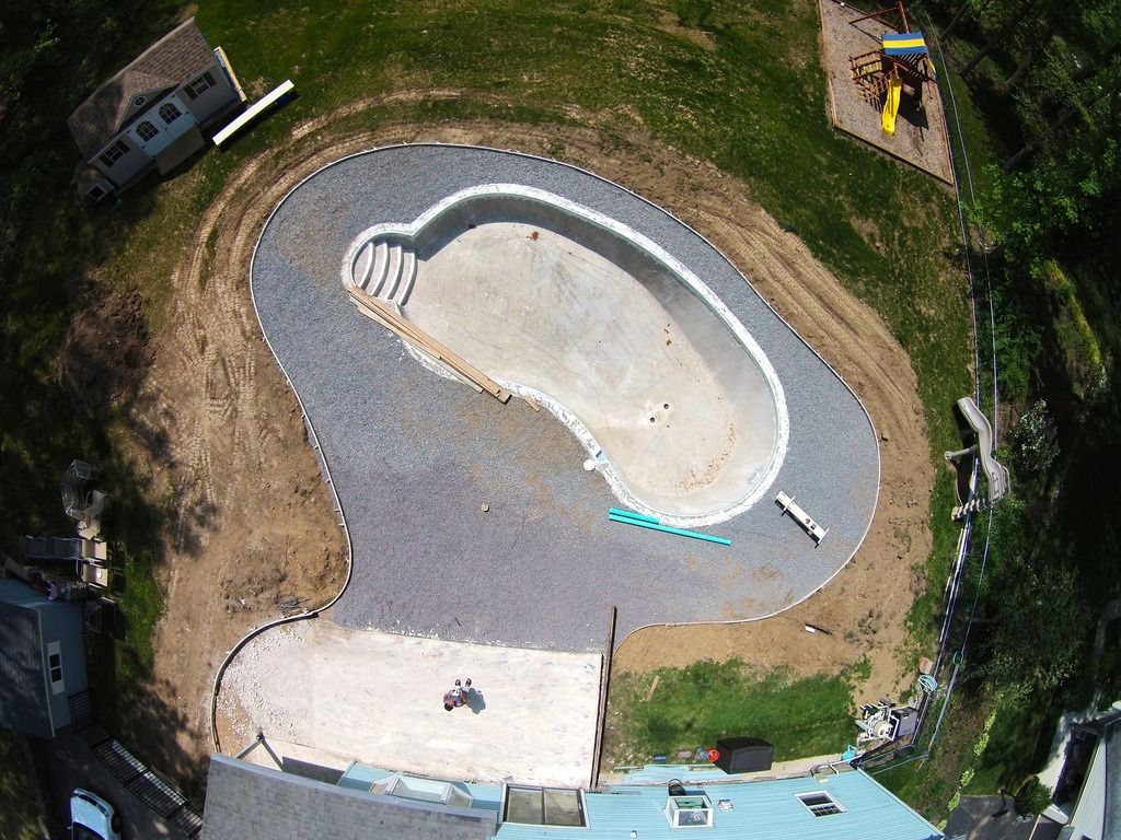

Plumbers did all the plumbing today. New bottom drain up to code with a double pot, core drilled and installed two new returns and pool cleaner line. All new pvc back to my equipment. So far i am very impressed with anthony & sylvans subs. They have not disappointed me yet.

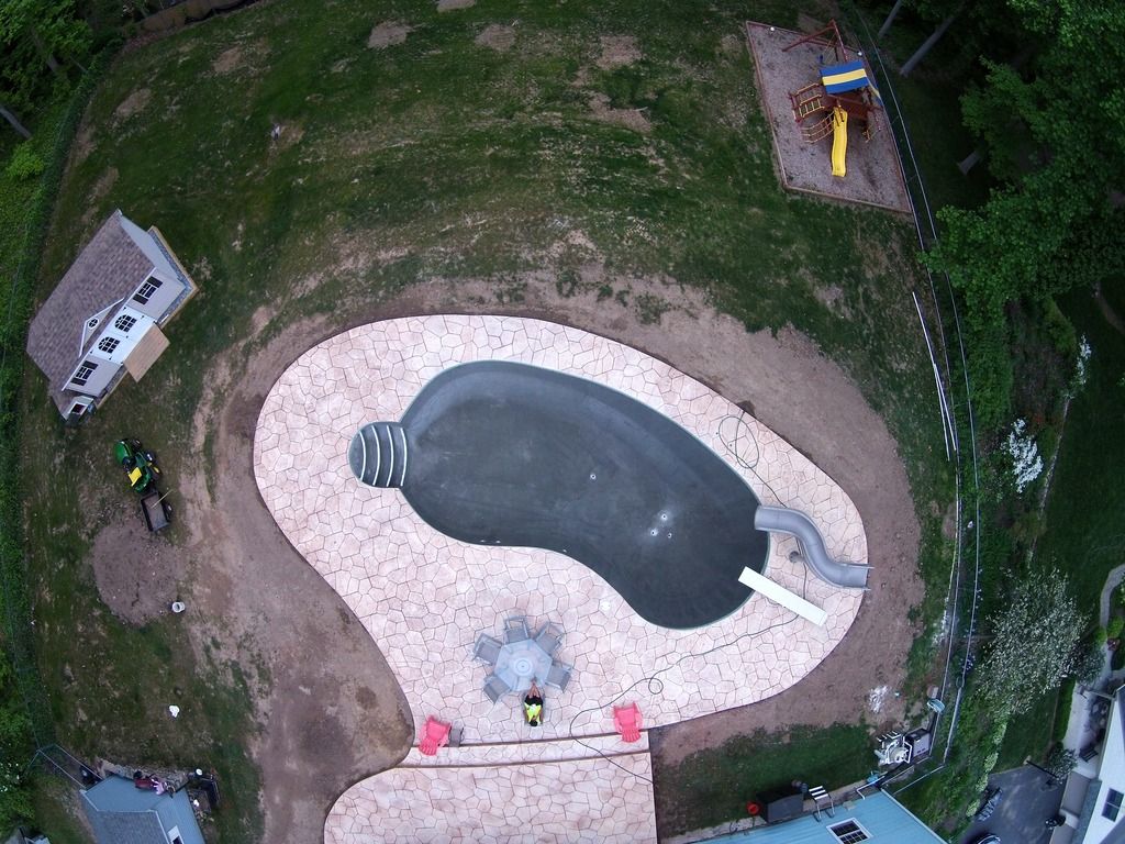

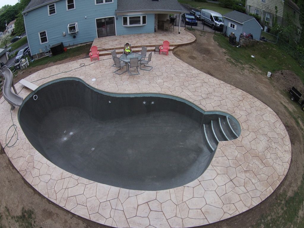

All prepped and ready for plaster tommorow.
