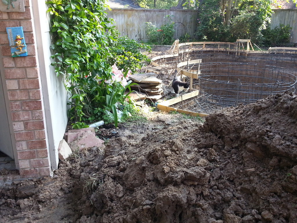

    I'm finally back posting after a busy, busy pool build week! Our forecast at the beginning of the week was for rain all week (80-90% each day). But as weather often does, it toyed with the weather forecasters... Monday was beautiful. Then Tuesday, my email message alert on my phone woke me around 8:30am. The email said, "The guys are on their way to start digging your pool!!!!" No lie - in five minutes I heard the big trucks rolling up in front of the house. Wow!!! It was beginning.
    They used the bobcat to pull up the 4' stump left from a tree, and then the rain began. We waited a few hours watching the radar app. It kept looking like the rains/storms would soon move through, and finally they did when our pb was just about to tell everyone to go home. Man, those guys got to work! Our pb spray-painted the outline of the pool on the ground, stakes were placed, and measurements were taken for the levels from key areas. Then came the real dig! The guy running the bobcat was amazing - like Mario Andretti!! It was unbelievable to watch him maneuver that bobcat. We wanted to line up bottles along either side of his route to the pool area - we were ready to bet he wouldn't have knocked down one of 'em.
    The day wasn't over, so the rebar gang came on board and began what looks to me like a cage. Again, so amazing to watch how well the crews do their jobs. These guys stayed until dark.
    On Wednesday, the pb's son, brother, and other non-family expert came to 'stub out' for the plumbing and electricity. I think that means making place holders in the cage so when the gunite is shot, all the plumbing and electrical connections can be made. Right? That's how I interpret it, at least.
    I have to throw in a couple of our outdoor cat, Killer, investigating "His Backyard". He isn't too happy about all of this destruction to his domain, but he's a good sport - we expect he will soon have his lady friends over for a lounge by the pool. BTW, Killer has been neutered since very young, but he still sprays, fights the toms, and enjoys platonic friendships with the gals.
    Killer headed to go on his rounds.

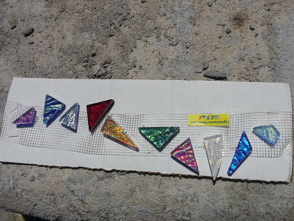

    OK, I took a ton of photos since I can barely see my phone screen in the bright sunlight. Then I had to cull out the best ones. Here is the plan so far for tile and stone. I'll list the materials - might be easier:
    * deck: Belgard pavers, Danville Beige (I'm still thinking about travertine pavers, but there's a lot of debate over how slippery they are when wet)
    * coping: travertine toreon
    * columns, back of bump out bench, and face of spa: ledger stone (probably a lighter shade, sand)
    * front of raised beam/planter at back of pool, inside of spa raised beam, and seat of bump out bench: a porcelain tile in a beige travertine look
    * spa spillway: either stacked ledger-type stone or the LightStreams glass tile, same as spa waterline tile
    * toe tiles: probably some of the same LightStreams tile, one tile on each outside edge of each step (maybe 3 on the bottom 2 or 3 steps since they are a bit wider)
    * sun shelf, outside edge: trim with LightStreams shell beach glass (not sure our pb will go for this; or it may be overkill; but I just love those gorgeous glass pieces)
    ** waterline tile, pool: TBD with ya'll's help (to go with whichever LightStreams tile we all settle on)
    ** waterline tile, spa: LightStreams glass tile, either Peacock or Steel Blue
