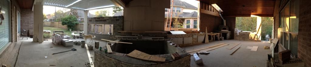

    A quick step back in time by a week or two. I found this panorama photo. The image the forum is showing does not do it justice (it's shrinking it from the PhotoBucket page for some reason). View the image (how ever your specific browser lets you do that) and let it zoom to 100%

    March, 2013.
    Everything was done at this point except for the pond. When the countertop crew laid the capstone around the pond, they ended up cutting into the liner and ruining it. It had to be scrapped. The problem was that the capstone was very fragile and already mortared into place. It would have been on them regardless, but I had an idea that could be a win/win.
    I had originally wanted to go with a polyurea spray in liner anyway, but the pricing I was seeing was very expensive. The liner was $900. Polyurea was pricing out to be around $3k. I called around and found a vendor/manufacturer that would do it on the side for about $600. It was a steal. Almost too good to be true. It wasn't though. Two years in and I am VERY happy this happened this way. The spray in lining is a much cleaner look.
    This is also where some additional woes came into play. Remember way back in the beginning I mentioned that the bottom drains had an issue because I thought they probably didn't get fully encased in cement and also were wrapped in duct tape and plastic? Well, when we cut the liner out, the pond had an inch of ground water in it that had built up behind the liner. This would have eventually run up the interior sides and kept the exterior stonework wet and probably caused a mildew issue.
    I had some work to do. Lots and lots of loud and dusty hand grinding work. It took 5 months from March before it would be done. Much of this was research and a bit of procrastination. In reality, I probably spent about 80 hours fixing this. It's too long and drawn out to fully detail, but I will say this. If you have water leakage issues or concerns with any cement project, look into Xypex. The stuff is a miracle.
