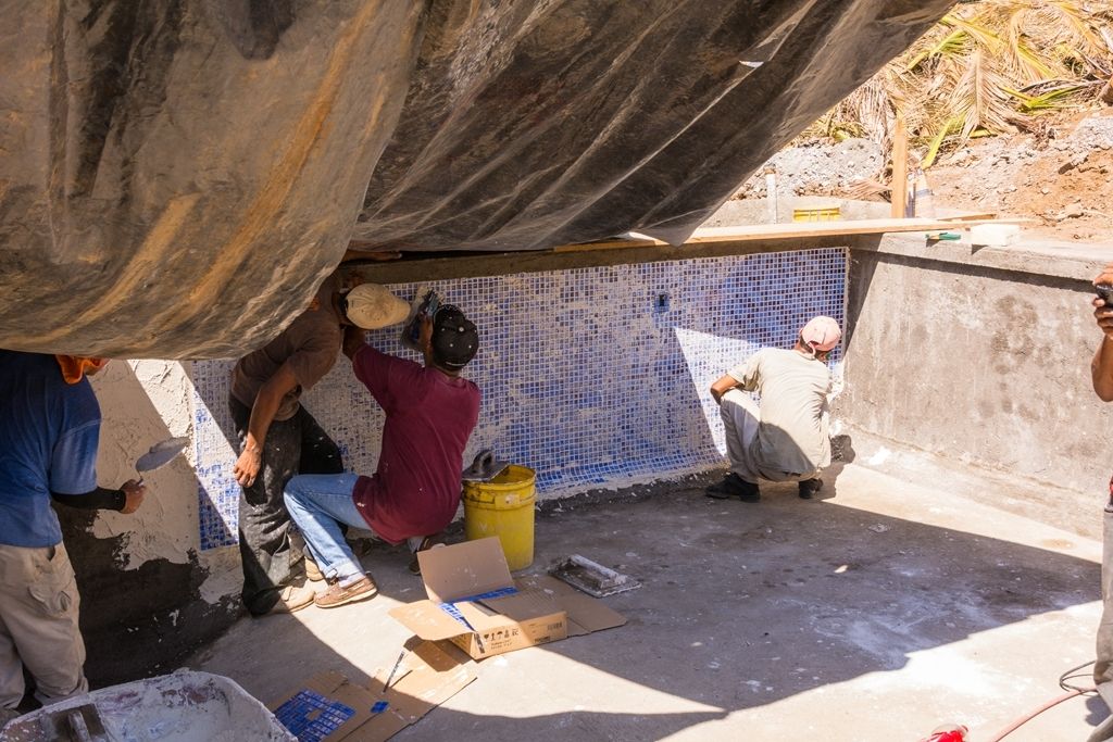

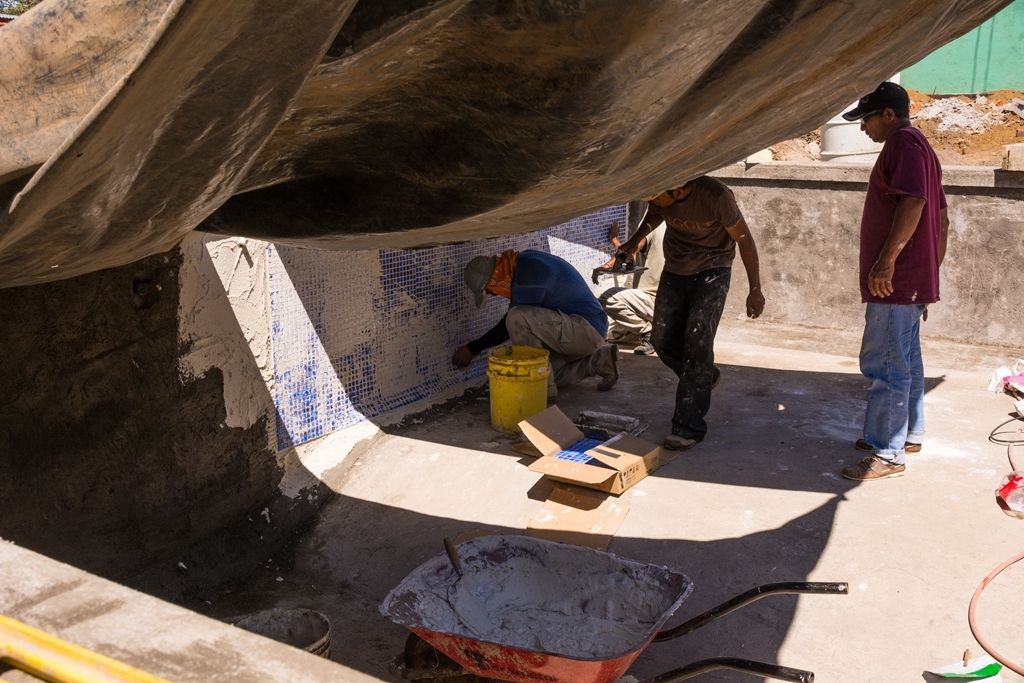

MrNica, can you tell us the process from a block wall to putting up the glass tile? Looks like maybe 2 coats of plaster first like a grey coat and then a white coat? Just how did they prepare the cinder block for this? I'm especially interested in this part since it is exactly what I intend to do with my pool and it is also a process I have rarely seen on this forum.
** I stand corrected. It is this series of tile. It is glass: http://www.homeelements.us/mosaic-tile/vitreous-togama-mosaic.aspx
About 1/4 thick,

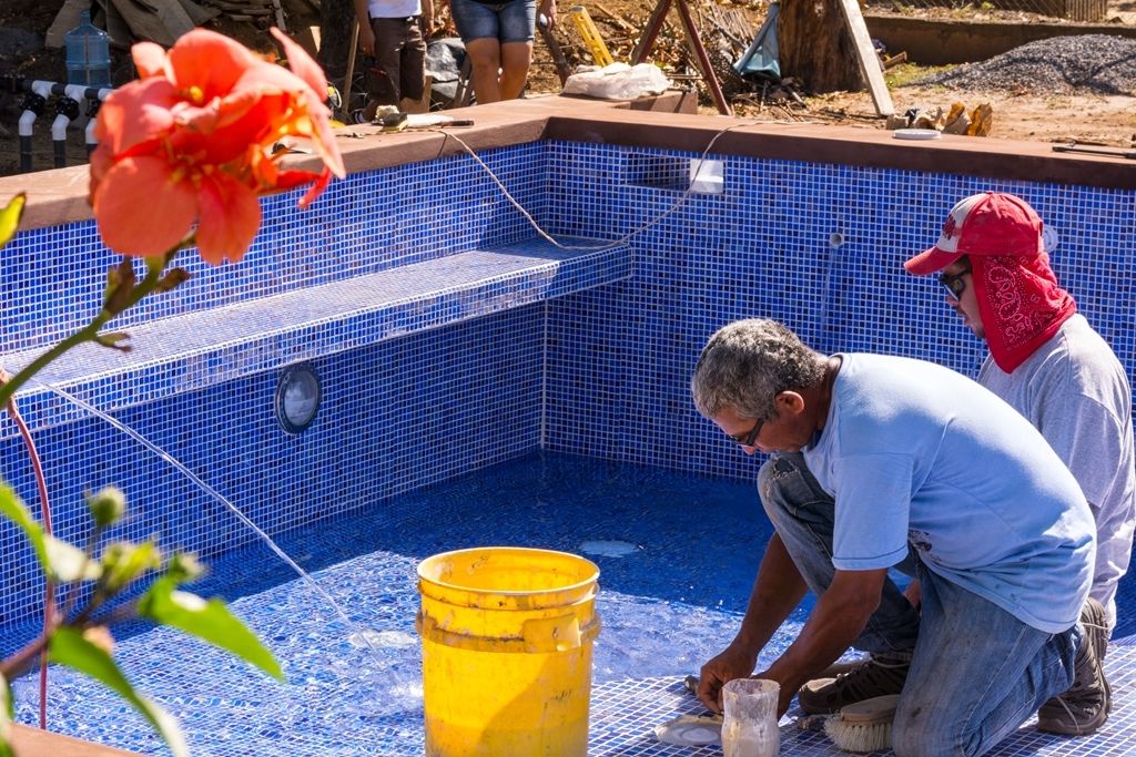

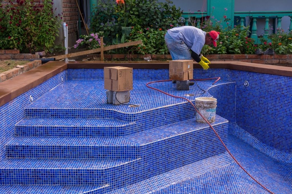

We used a very heavy hatchet to "rough up the block and the cement used other places like the steps to give a better grip. Then 3/8 of pool plaster. The white is specialized latex quickset about 7/16 - 1/2 thick. Then a coat mixed a tiny bit thinner is applied to the top surface using rubber trowels and then cleaned leaving the nice white between the tiles.
Will post pics of the cleaned tile later.
