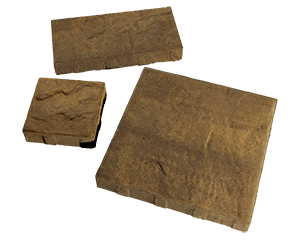

    I asked them about the finishing step of running the compactor over the pavers....They said they dont run a compactor over slabs this size as it could crack them. They usually only run the compactor over 6x9 paver stones. These stones are larger slab stones. I dont know if this is some sort of BS or if its actually a common practice. I dont really have a reason to doubt them because they have been good but I just wanted some outside advice from you good folks. They said that once the stone dust is in between all the stones, it should look much more even and smooth. Just as a reminder this is a Cambridge Paver Stone mixed slab set of 18x18 , 9x18, and 9x9 paver stones image below. Do you think these size stones can be run over with a compactor?

    I would agree with your mason. The point of using a plate compactor is to cover as many stones at once as possible and tamp them down. If the pavers are quite large, then you will not get good leveling using a compactor.

    I don't think you want to run a compactor over that large stone. If the stones really do have a 1/16 inch height variance I don't see how the contractor can reasonably be expected to have a variance of less than that after installation. As mentioned above the main problem with pavers not set over concrete is settling over time.

    I would be concerned also about cracking on large pieces
