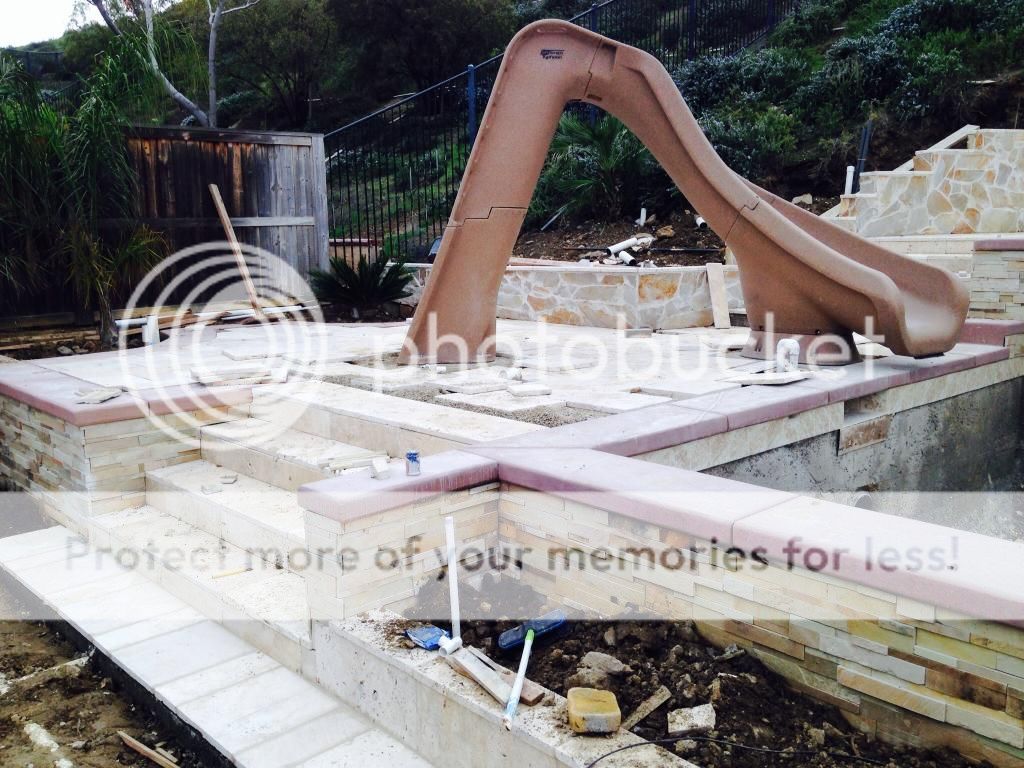

A little progress, taking it slow because I've worked out a deal with someone who's doing all the hardscape as a side job(just two guys). It's worth the wait as it's allowed my budget to remain on target, saved about 50% from what the lowest contractor bid was. It was the right decision, so far so good. . .

A few updated pics, but still finishing everything up, so I'll wait to post the entire yard pics as I've got a few more weeks of finishing up (I've taken up the rest of the project myself as a way to occupy my free time).
I was a little nervous that about how the fire would look but it turned out good. I have plumbing experience, so I felt comfortable enough running the gas, but wasn't sure how the burners would work. I've heard stories of low pressure which creates a weak flame, so I upsized my pipe and the results are pretty good.
