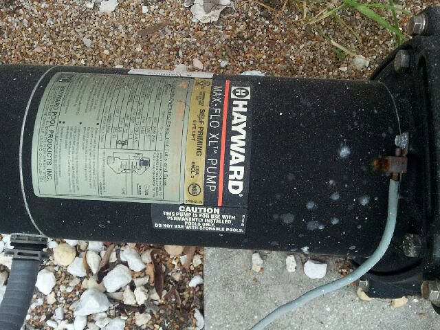

    Also if you can post some pics of your pump, filter and plumbing that will be extremely helpful in getting you on your way to a clear pool.

    • Not sure of the pump and filter make/model. I can check when I get home though along with some pics.
    • Also not sure what SWG stand for, but I do not have a second pump. Just the one pump and a single skimmer box.

    Here are some pics (first batch):

    Here are some more pics:

    Not sure what you mean. I added a pic just a few minutes ago of the filter housing but I think the moderators have to look at the post since I'm new to the forum.
    It's just a regular filter—about 4 ft tall, about as round as a dinner plate. I'm not sure of the brand or what material is used for the actual filter. It seems to hose out pretty easily.
    The pressure gauge is broken just due to old age. I do need to order a new one. Although, where does it go? The current one is at the base of the filter housing, while there seems to be a spot for it on the cap of the filter housing (which is currently plugged with a kind of plastic bolt that was there when I bought the cap (the old one was broken, so I bought a new cap and a new rubber seal) ).

    Hi, welcome to TFP! It looks like you may have an infloor pool cleaning system. The low, round thing is a Master Pools 5 port Turboclean actuator valve. If the system is working properly, when you turn it on little round sprayers will pop up a couple of inches from the bottom of the pool and spray the debris toward the main drain. From there debris gets sucked into the filter.
    Is there a label on the tall, skinny filter? Have you opened it up and taken the cartridge out? If the cartridge is not filtering well and you have cleaned it, it may need to be replaced. The pressure gauge also should be replaced. You need to track the rise in pressure to know when it is time to clean the filter. It is also helpful when diagnosing other pool problems.
