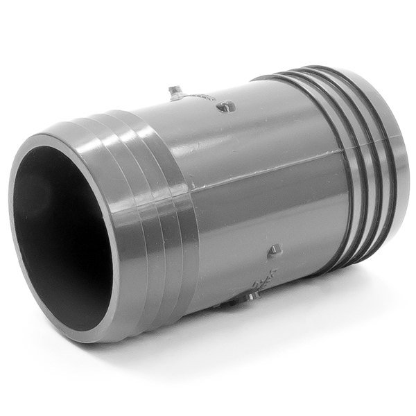

    My local pool shop has gray 2 inch barbed couplers that look something like this, except that they have a raised section in the centre unlike the one in the photo:
    Can you use this type of coupler with white PVC pool piping? Or do you need the white couplers that look like this:
    Vinyl 18'x36' in-ground 100,000 L, Jandy Aquapure 1400 SWCG, Jandy Lite2 heater, StaRite System3 filter, Evac tube solar heating panels

    The barbed coupling is for hose, not pipe.
