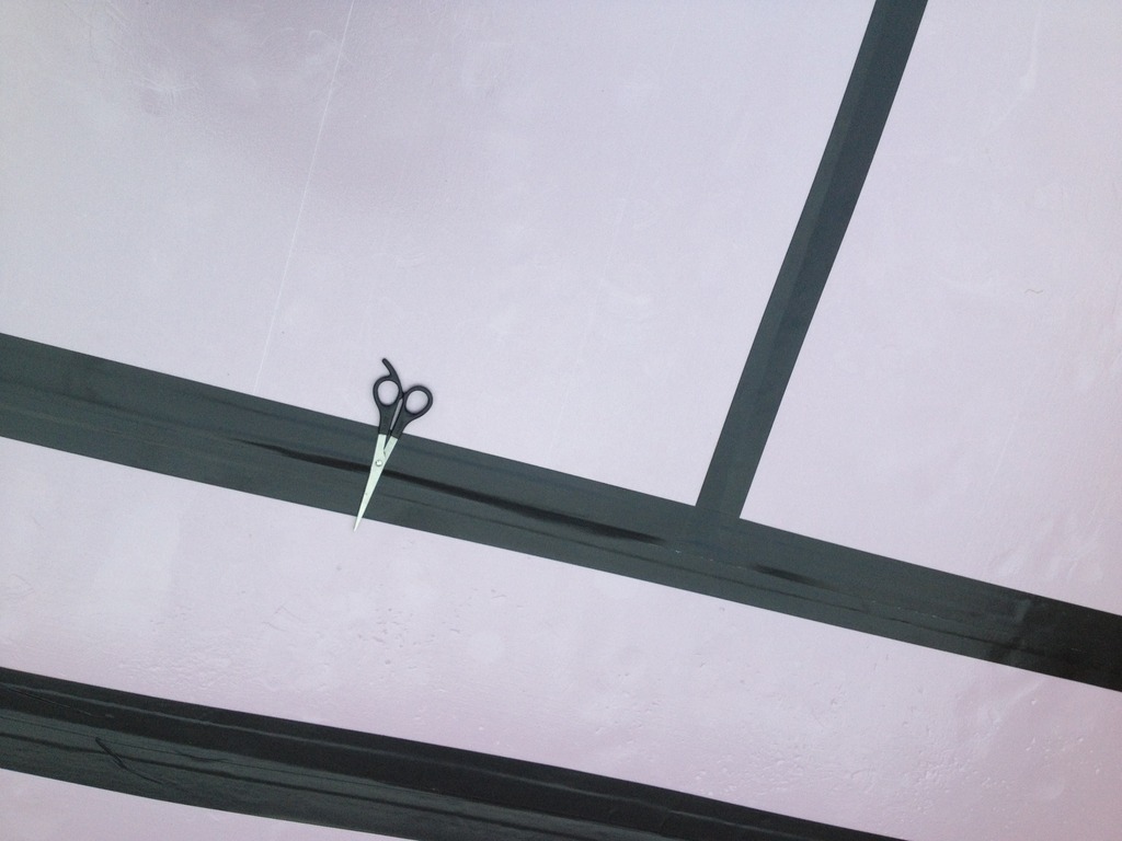

    I first put down the heavy duty tarp. On top of that I put down the pink 3/4 inch foam insulation and taped them together with gorilla tape. In the first image you can see how I pieced them together and then in second image it shows how I put more tape on each seam. It is a good idea to place as many rows of tape over each seem so that they don't separate later.

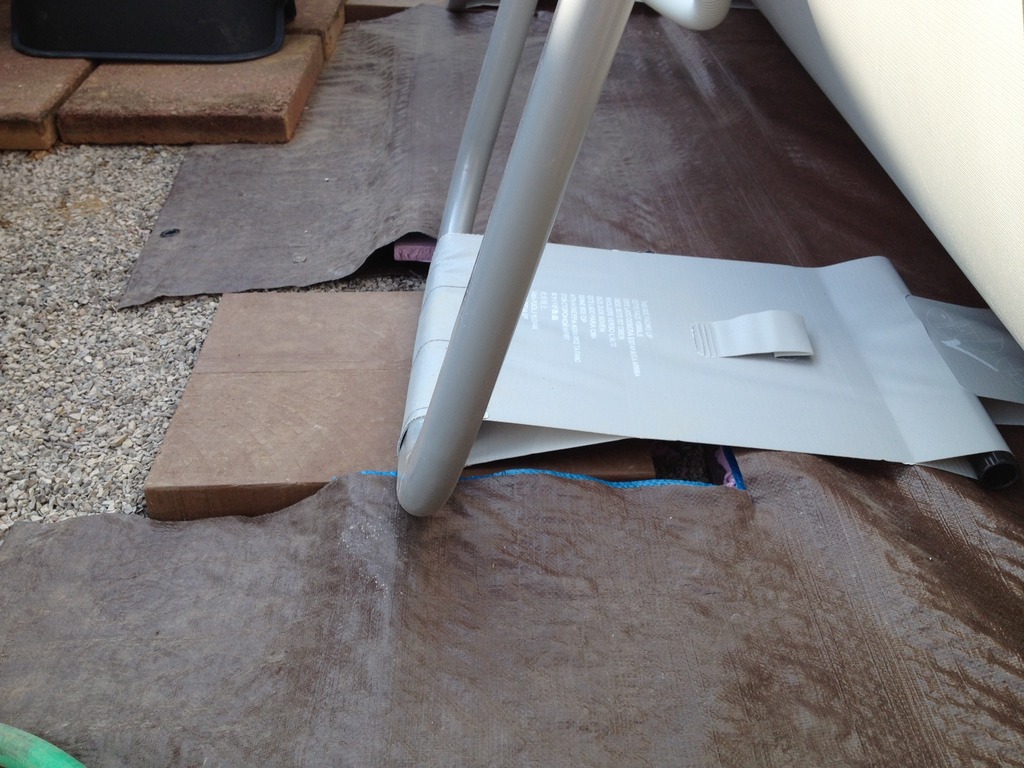

    After the pool was set up and the pumps attached, you can see how the footings were placed. In the image you can also see that I used the cheap blue tarp that came with the pool over the pink insulation and then placed another heavy duty tarp on top of that. So it is limestone, HD tarp, pink insulation, blue tarp, HD tarp, then pool. The insulation came out past the legs though not enough for the wood footings to sit flush so I cut out an area for each wood footing. The wood footings are 2 inch thick, 15 x 12. and stained for added weather proofing. Make sure you sit the legs of pool in middle of the wood pieces because as it fills up, the pressure causes the legs to push out some.
    Here is an close up shot of the wood footing.

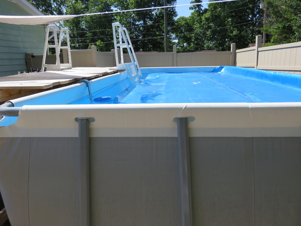

    I bought a ladder that I was able to separate into two pieces and attached to deck and other into pool.
    Top View with Intex solar cover and Intex skimmer that does a decent job.
