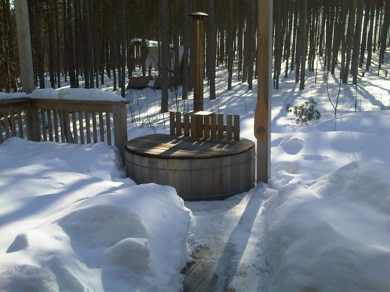

    #1 - tub is built, deck under construction... note the nice new cedar colour
    #2 - deck covered & filling tub for the first use, note tub is now grey (finishing the deck took longer than expected)
    #3 - typical winter appearance although cell phone camera made it look a *bit* more dark and gloomy than usual

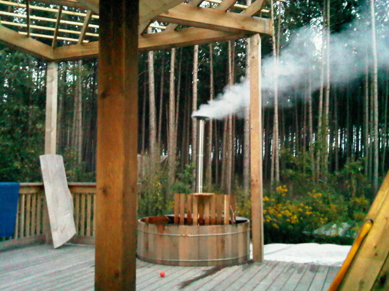

    Here's a better pic of tub plus deck, taken last fall. The benches inside are at deck height so getting in and out is easy. The chimney only smokes when the fire is starting or damped down -- normally there's no smoke at all when it's burning hot.
    Cedar hot tub, 680 US gallons - Snorkel wood-burning heater, canoe paddle, "offline" Intex 1000 GPH pump/filter with skimmer

    Well, this is certainly an interesting setup. Sorry you had the trouble, but I'm glad you posted so we could see it.
    Really neat, and I like the seclusion implied there with the woods in the background. Nice.

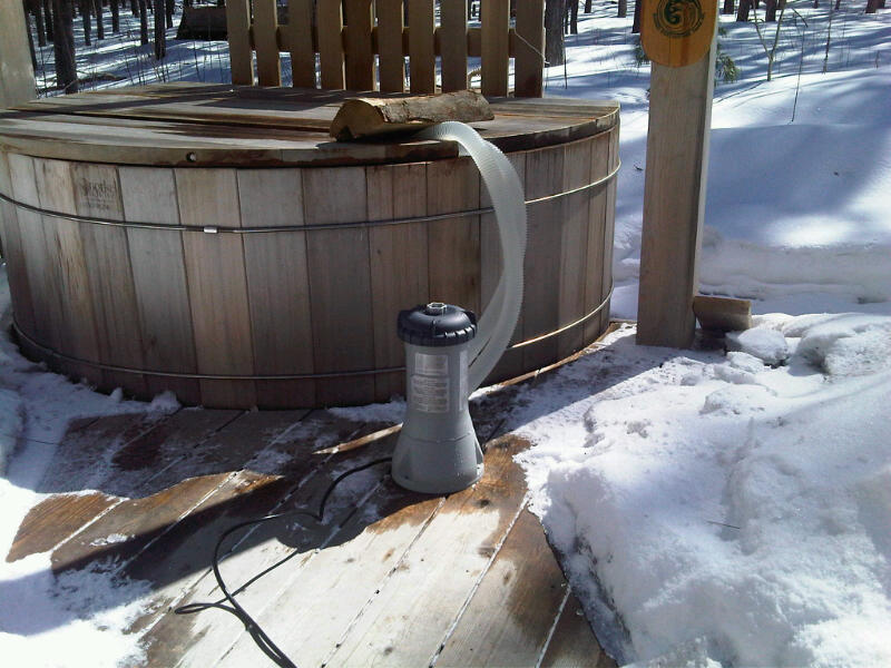

    Here's a less-depressing winter shot, taken this morning. You can see the "circulation system" hanging from a hook to the right of the tub.
    I would have dug out a wider path to the tub but there's a few inches of ice hidden in the snow, left over from the last ice storm. It's easy to get through the ice with an axe or a 500,000 BTU propane torch but I don't like using either of those on my deck, and clearing the whole deck with hot water seems like something I'm not quite sufficiently obsessive to attempt. I should try to get rid of the ice on the path to the tub though...
