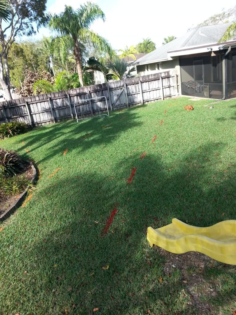

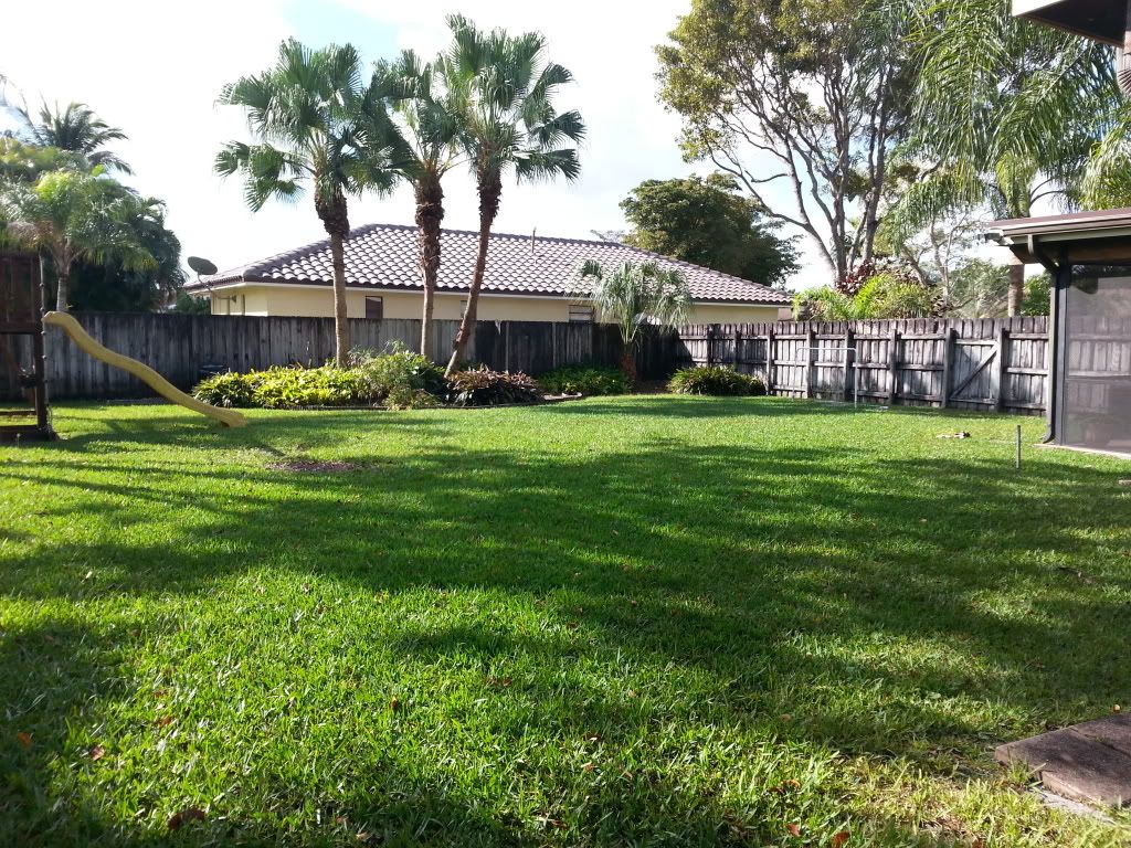

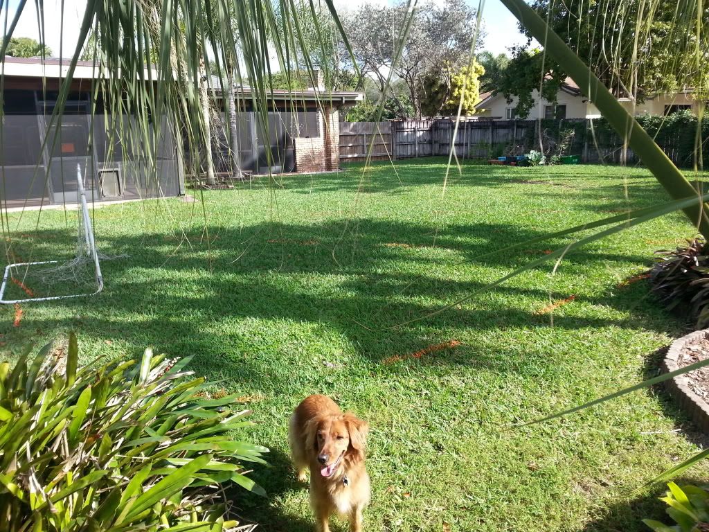

    Here's a few before photos:
    A nice empty yard
    Looking toward the house

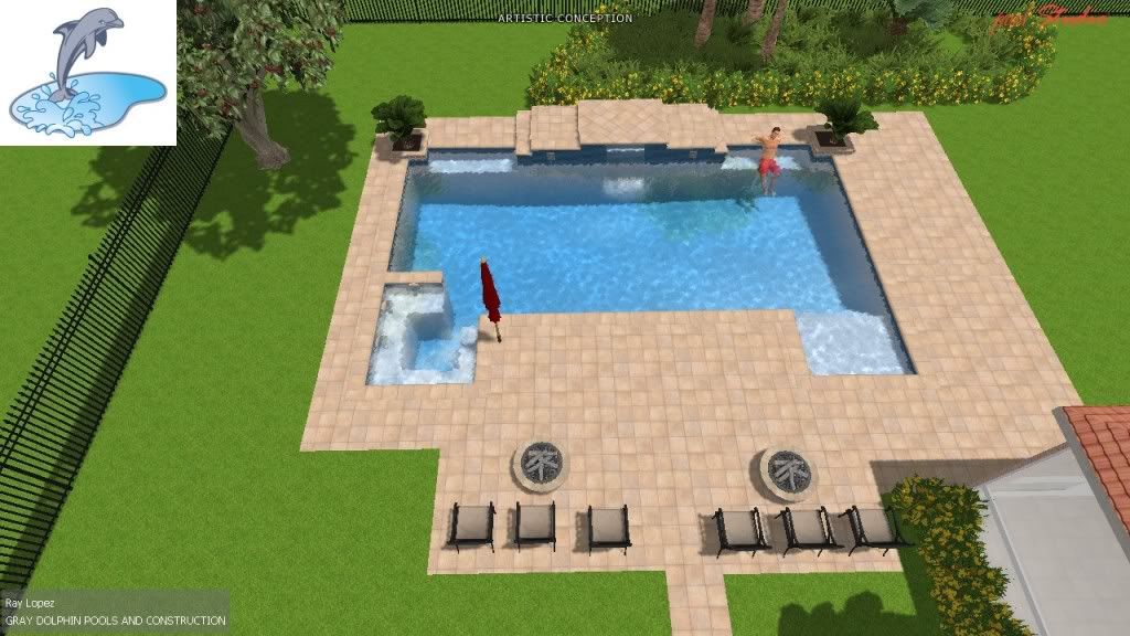

    Our pool design
    And already a hiccup. Utility companies are marking the underground lines and so far electric and phone are located in pool area.

    Nice yard and love the trees. Beautiful pool design!
    Dang it

    Good news is utilities can be relocated, bad news is it isn't cheap.
    It'll all be worth it (that's what I keep telling myself)

    More complications developing ...
    gas company marked the gas line and we have a main line running through our yard. Extremely frustrating as electrician wanted to reroute electric to this location. Now he's looking into moving right up against our property line to keep it out of the way.
    furthermore, the underground transformer is located right beneath a tree that I must first have removed before they can begin.
    And to add insult to injury, architect tells PB our lot has larger set-back requirements and pool must be shifted further away from property line. But, with pool shifted over, it blocks a screen door to our back patio. The whole thing looks funny and off. PB is going to brainstorm but I'm completely discouraged. Expenses are racking up and we haven't even started yet!

    I appreciate all the feedback. Most people seem to document their new builds with excavation. I was unprepared for all the issues that could arise before getting to that point!
    cbink - you are right about those surveys being incomplete! Ours designates a 6 ft. utility easement that none of our utility lines are located in!
    mrcarcrazy - you are not kidding with that mantra! I will repeat it regularly. I had a chuckle over your fence. We are going to take down the portion of fence by the house and rebuild it on the far side of our property and we get the same response -- "We can just wait until the pool is finished." They will be working nowhere near each other!
    At any rate, we are redesigning with the given limitations. At first we considered simply shifting everything over, but the pool looked "crammed in" and when you walked out one of the doors, you were stepping directly in front of the pool. The tanning deck was just a few steps in front of the door! We decided to remove the tanning deck to get the extra distance from the house and instead put corner steps in. Also, we shortened the length of the pool from 35 to 32 and increased the width from 16 to 19. This moves the edge of pool away from that patio door. I think it's a better fit that way.
    We'll probably have to add more decking behind where the chairs are currently located in the drawing.

    Sorry you lost the sundeck, but I still find the design very modern and spacious. Are you on septic or sewer?

    It's beautiful. But Couldn't you add your tanning ledge back in next to the spa on the new design and extend more decking behind that end?

    Looks good, but I'd leave a few feet between the decking and the fence so you could plant some landscape. You're going to want to break up that long fence run with some sort of landscaping. You could use pots as well
