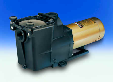

    So I wasn't positive which end you would consider the back cover of the motor. Posted 2 pictures for you to see. I am assuming it is the end of the motor (silver) and not between the motor and the tank part?? There were 4 long thin bolts that went into the housing and two smaller ones that held a small plate that covered some wiring. I wasn't able to pry the silver end off. I was afraid that I might crack it. Any thoughts??
    Thanks for your help.
    lyn

    Can't tell for sure from the pic but it looks to me like you might need to remove the green screw.

    The green screw is the grounding nut. It doesn't hold the motor onto the pump. This is a split phase motor and does not have a start capacitor. Here is a link to the manual and parts list for this pump. You will probably need to replace the motor and shaft seals.

    Before buying a new motor, there's one more thing you can try. You'll have to take off the cover in the back, that silver plate at the end with the wires. With those four long bolts out, it's just held in by friction. Take a flathead screwdriver and gently tap it out. Once you get inside, you'll see the centrifugal switch that might be sticking. See this thread for more info. Post back if you have any questions.
