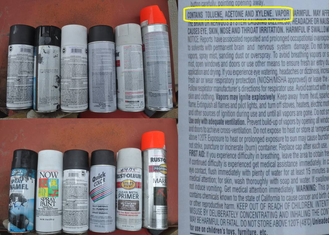

    I looked at all my paint cans which I had lying around on the paint shelves:
    All say: Contains Toluene, Acetone, and Xylene vapor ...
    I'll see what I can find in the hardware store & report back ...

    I've used the Quick Color shown in your picture and it works fine without any damage to the PVC. Like I said before, it isn't wet for very long plus acetone, the same stuff used in PVC glues, actually helps it stick better.
