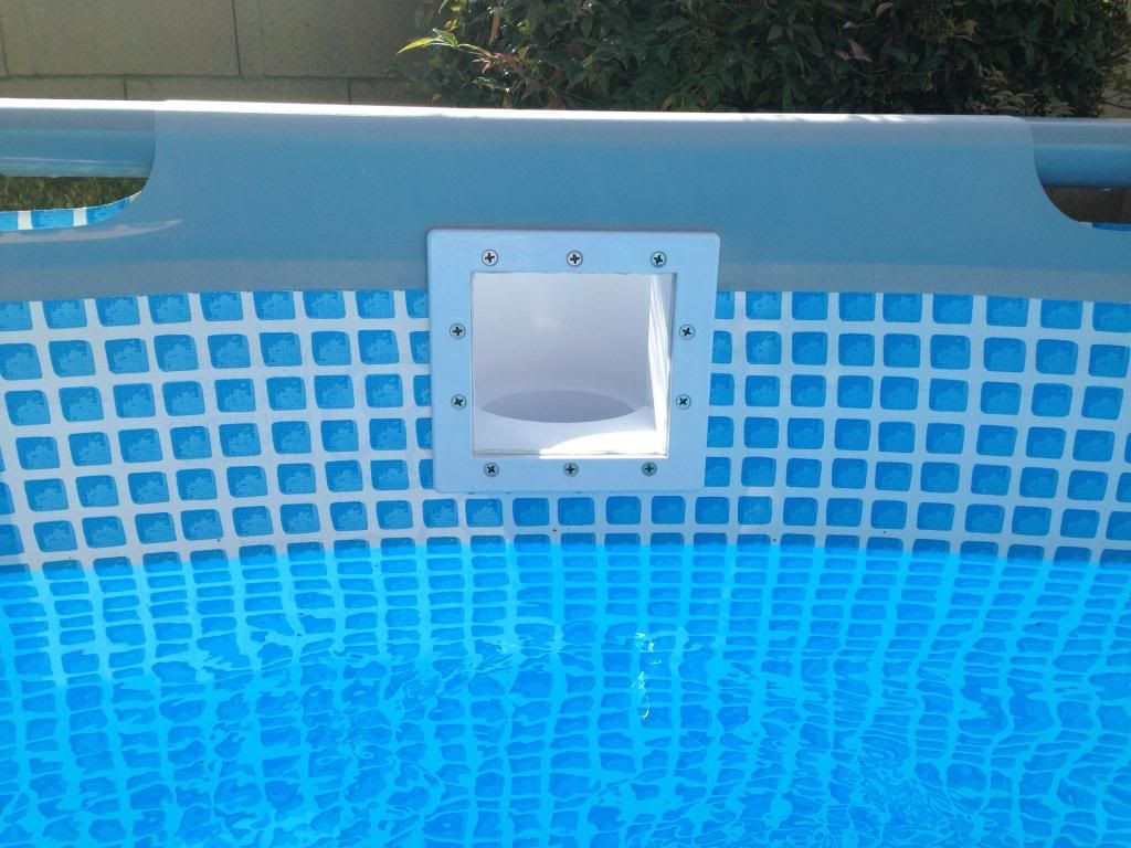

    Thanks to your excellent inspiration I installed my Hayward skimmer this morning. It went superb, and I was really pleased with how it all turned out.
    For my install I decided to go higher up the wall to preserve my water depth. I also adapted the skimmer to my stock Intex hoses because I take the pool down every fall.
    Here are a few pictures:

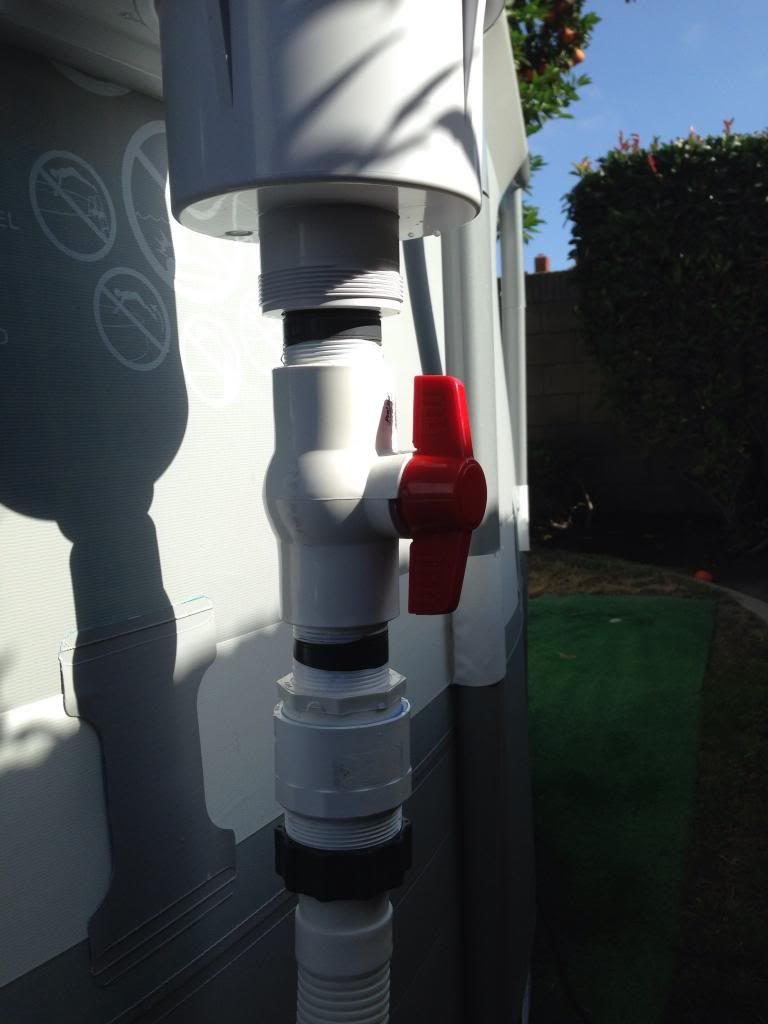

    In the process of adapting to the threaded coupler on the Intex hose I discovered that it would attach to a standard 2" PVC male adapter which made the connection a simple screw on deal and will be simple to take it apart and store later. Also, because I forgot to order some extra Intex rubber gaskets for the connection I was forced to find a work-around at Home Depot.
    To my delight I found a rubber "Bath Shoe Washer" that is made for the drain outlet of your home bathtub. The inside diameter was perfect, but the outside diameter needed to be trimmed with scissors to fit inside the Intex coupling. I stacked two on top of each other so they would be thick enough.
    It worked super well and not even a drop of water has leaked after running the pump all day.
    I couldn't be more pleased watching the leaves and bugs getting sucked into the new skimmer

    That's a good looking installation!

    I chose the standard skimmer because I was uncertain about if the circumference of my pool would be an issue for a wide mouth. Specifically if the sides would be too rounded to comfortably accommodate it. However, it seems that it's probably not an issue, especially for a 20' Ultra.
    I saw how great the Intex wall hung skimmer worked, and it's pretty small. So I really wasn't concerned about the standard version being too small either.
    My kids were too crazy with the intex skimmer and essentially destroyed it with their whirlpools and rough play!

    ...I wish you could tell me all the exact parts you used so that you could screw the hose on...
    OK, here ya go. The list will be in order starting at the 1.5" female threaded outlet on the bottom of the skimmer:
    1.5" x 2" PVC SCH80 nipple
    1.5" FIP x FIP threaded PVC ball valve
    2" x 1.5" Slip x FIP SCH40 PVC bushing (get it from a real plumbing supply house or order online)
    2" PVC SCH40 male adapter
    The key pieces are the last two. Especially the 2" male adapter that has the exact same threads as the Intex hose coupling. However, the male adapter has tapered threads that tend to tighten up before it is all the way seated against the intex rubber washer. That is why I put two washers in there. It worked perfect the first time with not even a drop leaked. I was soooo relieved!
