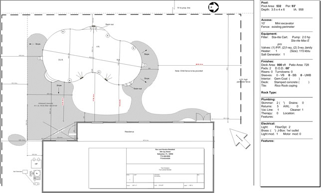

    Here are the specifics of my pool build:
    35' x 19' IG Gunite free form with two swimouts
    3.5' shallow to 6' deep end
    96' perimeter
    18,000 gallons
    2 skimmers, 5 returns
    No main drains
    1 HP filter pump (Sta-rite Max-e-pro)
    1 HP waterfall pump (Sta-rite Max-e-pro)
    Polaris 380 cleaner with booster pump
    Sta-rite system 2 modular filter
    Goldline Aqua-logic P-4 automation system
    Goldline Wireless base and handheld remote
    Goldline SWG
    Fiberstar Fiberoptic lights for pool and waterfall
    RicoRock 4' double modular waterfall
    RicoRock 9" coping for perimeter
    RicoRock notched boulders for perimeter
    Rheem 8300Ti heat pump
    Florida Gem "Kahena" pearl finish to produce dark blue water

    I'm curious though about your depth decisions. Why 6' at one end instead of the middle?
    Mine is 3.5 x 6 x 4 - Mine was already here, though, so I didn't make any of the decisions. It's great for volleyball.
    Anyway, I was just curious at your thought processes in the design of your pool. My DD is planning on putting in a pool at her home next year, so I'm gathering info and find it interesting to read why people make the decisions they do about their pools.

    Ours is not as long (32') and we opted to go from 3.5 to 5.5 because otherwise it would have felt like the whole pool was sloping. This way it is a subtle grade. I think people who use their sports pools to play volley ball are more the exception than the rule. It's great if you do it, but I just figured the odds were that after a time, we wouldn't do it much. Whereas we enjoy the extra usable space everytime we swim.

    My kids are not much into volleyball, but they love to dive down "deep" and pick up things off the bottom etc. Also, we will be putting a slide on the deep end. Just thought it would be best to have a larger area of deeper water. Ron
