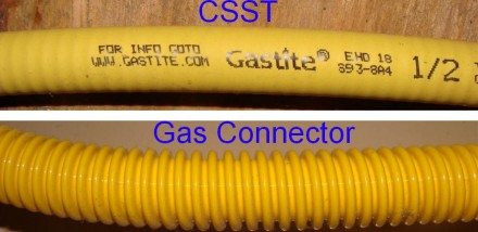

    There are some flex hose alternatives, like CSST. It's a corrugated stainless steel tubing that is typically coated with yellow plastic. The plastic coating gives the pipe a fairly smooth appearance, but you can see the shadowing of the corrugations through the plastic. You could use that, but you'd have to bond it to ground. Don't confuse CSST with gas appliance hook up hoses. They can also be corrugated and coated yellow, but the yellow coating on the hook up hose is a very thin coating of plastic, so the exterior of the hook up hose has that rough corrugated appearance.
    If you shop, you might also see what looks like a simple yellow polyethylene gas pipe. It looks similar to PEX for household water supply, but it's yellow. Do NOT use that. It's for outside service burial runs. This stuff is a no no for interior use:

    I have read conflicting answers on the CSST outside. It is what I have inside from the main line to the black pipe outside, and it is grounded and bonded. So which is preferred for that final connection between the pipe and the grill, the appliance hose or the CSST, for an outdoor installation in a northern climate such as Ohio, knowing it is completely inside the kitchen island?

    The CSST would have been for inside the house. And that's fine, because it looks like you're all set with the stub out and valve already in place.
