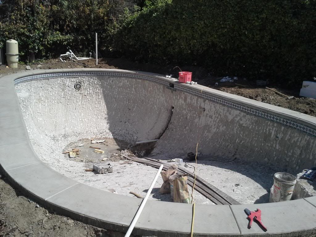

    So here are a few pictures of the progress...we are going at a slow pace, which is fine with me (where is my tax return!?!?!)
    We decided to go with a pour in place coping instead of the bullnose brick as we thought it might look better with a paver deck.
    We also decided to add more area to the decking and take it all the way to where that addition is, where I will eventually put in a slider or french doors (leads to the kitchen area).
    There was an iron gas line by the pool equipment, and I thought we would extend it back to the new equipment area. Opened the valve and it's dead only to dig up the whole like and find it was never tied in...must have been a "future". So now that we are in the future, the builder is going to put in that yellow pex for "future", again.
    We were really confused with picking the tile (too many options), but we are happy with the tile now that it's up. Also, you can see in the second to last picture where the new main drain will be coming through the shell since we are filling in the deep end.
    We are tentatively going with 5 1/2' depth on the deep end.

    Excellent choice to go with the poured concrete coping (I'm no fan of bullnose brick). For us, a pool cannot be too deep, so I would never fill a deep end in, but that's an individual choice. We just finished our renovation so your pics of the demo are only too fresh in my mind. Ours looks new and yours will too! Excited for you!

    What is the width of the coping? Any pics of the work being done? I.e with forms in place? Do you know the name or make of the profile? Stegmeier?

    Yeah, I'm with everyone else...that coping looks great! Still going for the white plaster?
