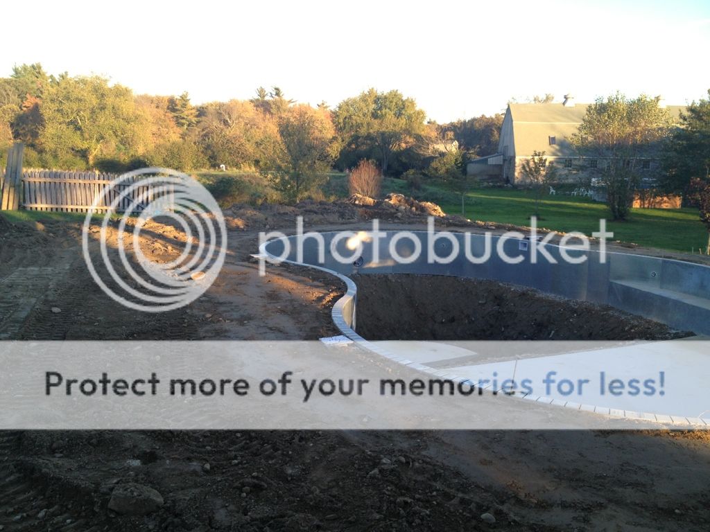

So here are some pics
Here are tha areas I am still trying to figure out.
Still have a lot of leftover dirt.
And because I absolutely had to
Here is a view from today as rain pours down on us again. At least my land will settle some!!
