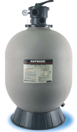

  6. Back To Top    #6
    Re: Skimmer basket dislodges when pump turned back on
    This is my filter, can't seem to find one on it.

  7. Back To Top    #7
    JasonLion's Avatar
    Join Date
    May 2007
    Location
    Silver Spring, MD
    Posts
    37,879
    That filter doesn't have an air bleed valve. Just ignore my comment.
