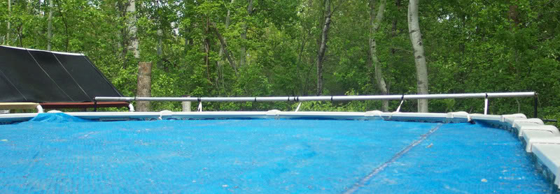

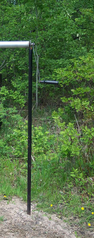

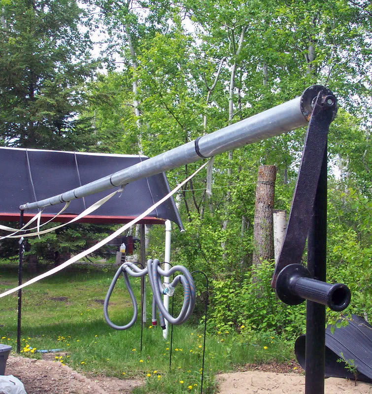

    Cover Reel
    Matt is the one that came up with this design I used - He has a round pool and I believe Huskerfan (Donya) on PF also has a round pool and used Matt's design as well, except I think she used a swing out design so it was moved out and away. Ours uses 1" black steel pipe for the uprights/posts which stand appx 1.5' above pools top rail - they are concreted into the ground appx 1'. The conduit is 2" -
    Its funny I saw this thread again today as we were working on these this week anyways. I just ran out and snapped some pics. We are in the middle of replacing the straps so they are not re-attached perm to the conduit until tonight - DH originally attached them too short to start with and I have since then been unhappy with the 2" gap it left at the front of the pool so I cut them and replaced with new except to attach to the conduit. I have them wrapped and taped until he wakes up - he is on shift work so I am guessing just about sundown I will have them attached again at the length I LIKE! He rivets the straps. (excuse the long grass/weeds - its been raining for days and now teenagers need to get busy with weed whip today!)
    black steel posts/pipe into the ground
    from front of pool viewing the setup
    [color=]View of the crank - bearings welded into large washers, welded onto post/pipe[/color]

    Is the conduit empty? Does it handle the weight well with the cover on it?

    Yes it is empty and it has never sagged. We originally built it with the black iron welded across too - but that DID sag. The hollow conduit works wonderful - even when the cover is rolled up and has some water in it, no sagging AND it is light and easy to roll up or out. This works so GREAT, I love it.
