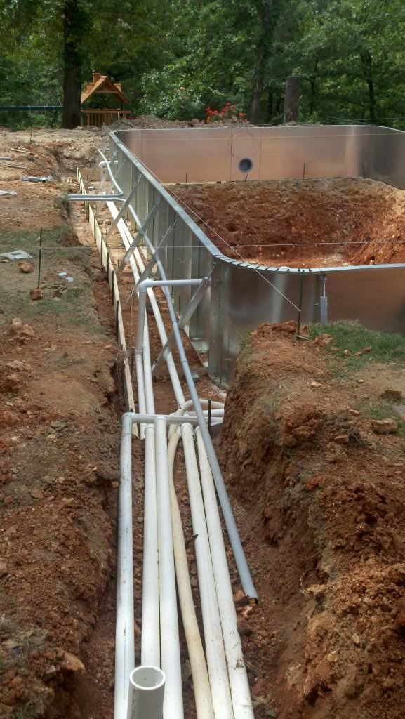

    Re: New pool build and bonding
    http://i1075.photobucket.com/albums/w43 ... -00_56.jpg
    this is pic of pool so far with braces in center for concrete footer pour.
    http://i1075.photobucket.com/albums/w43 ... 54_565.jpg
    Here is the skimmer pushed back.
    http://i1075.photobucket.com/albums/w43 ... 29_109.jpg
    Outside of light niche with bonding lug
    http://i1075.photobucket.com/albums/w43 ... 41_599.jpg
    Inside of niche with internal bonding lug and plate
    http://i1075.photobucket.com/albums/w43 ... 41_820.jpg
    Plumbing. 2" rigid pvc.
    http://i1075.photobucket.com/albums/w43 ... 05_413.jpg
    Skimmer rigid 2" plumbing (primary) and 1.5" flex pvc ( back up) line. Back up line will remain plugged from both ends unless needed in the future due to failure of primary line.
    http://i1075.photobucket.com/albums/w43 ... 16_210.jpg
    Pretty straight I think.
    http://i1075.photobucket.com/albums/w43 ... 02_116.jpg
    Main drains not so level but I think they can be slightly torqued into level.
    The back fill has been delayed to monday so I am going to work on the equipment pad and bonding in the mean time.
    more pics to come.
    Oh and this was all done in 9 days so far!!

    well, the back fill and grading will be finished tomorrow. I expect my conrete guy will want to come back asap to start laying forms for the deck pour . Last night we cut and installed the coping and laid the equipment pad and set up the filter and pump to start the plumbing at the pad tonight.
    My frustration is goin to be having the step cups in the right place so that they are level with the pour of the concrete. Both the ladder and the hand rail that is at the main step area have two seperate cups and getting them positioned correctly seems tricky. I thought about fabricating some sort of jig to keep them related to one another or driving in some rebar to slip them over. The deep end ladder could be placed with the cups attached if need be but the hand rail is a cantiliever style and would not stay in place. Any ideas of how to get these two cups ready for a concrete man to be able to put them in the right spot would be helpful.
    As soon as the sun comes up I will get more picture updates.
    Oh, and the weight of the rock pushed the skimmer back flush so no worries!
    Nearly all the plumbing at the equipment pad is finished
    The runs between the pump and filter is delayed to decide which swg to put in line there.
    http://i1075.photobucket.com/albums/w43 ... 28_733.jpg
    Well that can be done too
    Guess I can go ahead and run the line between the pump and the filter!!
    As the picture shows. I have a long run between the filter and the first valve I could easily splice in the generator.
    One snag I ran into was the compression fittings. The ones they sent for the filter cant physically fit side by side. They are too wide. I will have to add an additional addapter to step one out away from the filter so the compression fitting will go.
    15,000 gallon, IG Diamond Brite plaster, Hayward Max Flo 1.5HP pump, Pentair Clean and Clear 100gpm cartridge filter. http://imgur.com/xHFxE
