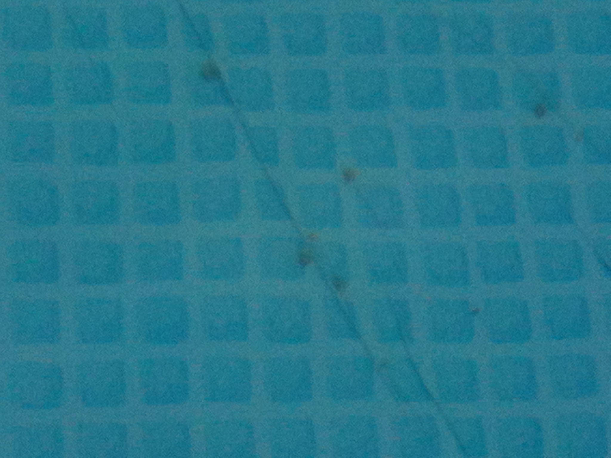

Tonight I came home, vacuumed, brushed, backflushed, topped off the pool with tap water, let the filterpump run for an hour or two, then measured again. My FC is at 17.5, CC at 1.5, and (FINALLY!) the water is crystal-clear. I am seeing more "rust spots" on the liner. I tried to take a picture:
These are popping up all over, always on the bottom. What are they? It's not dirt; it won't brush off.

LS1M said:
Would "culprit" include a screw that I dropped in while building my ladder? I couldn't even see it until recently, and the water is too cold to fetch it out. It's such a small screw, though....
That would seem a likely source if it was not a SS screw.
I have a few spots from a hair beret ... going to have to keep a better eye on who comes over to use the pool :evil:
