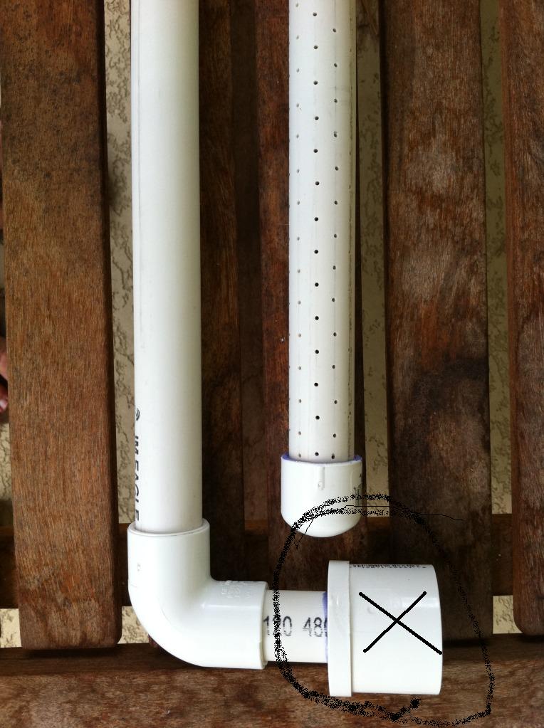

Here are 2 of mine...just one of many examples I'm sure...approximately 4ft in length...all parts from Home Depot...
http://www.youtube.com/watch?v=SuOde_o-1Yg
I have a total of 6 returns plus an additional one for the Polaris...
I am using the pool PVC coolers in 4 of the returns, and had to plug one up to make the sprayers shoot any kind of distance...
And yes the hole sizes are 1/16"... and approximately 210 holes per tube...
