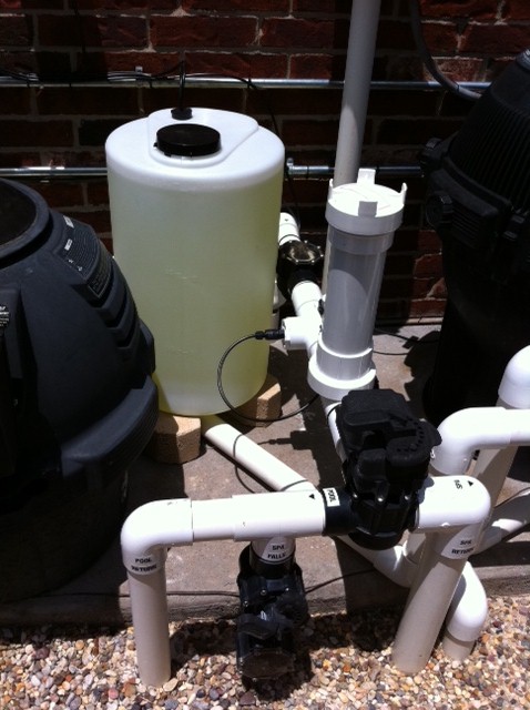

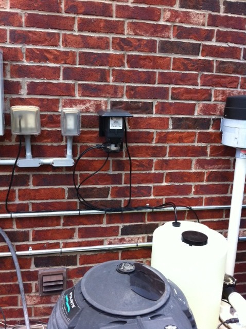

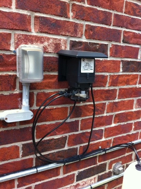

    I got the pump installed today. Very easy. I linked it to one of my aux relays on my easy touch. The way I did that is the outlet is fed by the relay so I just plugged it into the relay. There are three outlets in the picture and they are relays 6,7 and 8 respectively. The second picture shows the section where the Pentair 320 inline chlorinator and injection ports, which replaced my Intellichlor IC40, reside. There is a second 1/2" fitting opposite the chlorine injector. I did this in case I want to add PH injection as well. At this point I just need to figure out how long to run the pump. It is a fixed rate pump (45MPHP22) which will do .92 gallons/hr or 1.96 ounces/minute. I think I am right at 110 oz/day so need to run the injection pump for ~56 minutes every 24 hrs. I will most likely split this up into 2-4 injections of 15 mins to even out the distribution. Overall I think this is well worth the $302.00 I spent for the pump and tank.
    The one question I have is on the last picture the tube is not in the middle of the rollers. Is that normal? Let me know.
    Thanks!

    It tend to find it's natural 'center' so it doesn't matter that it's not perfectly centered on the rollers.

    I just hooked up my stenner to my Easytouch. Something dawned on me that you ought to consider as well. Set up a egg timer on the circuit you are using to operate the pump. If someone accidentally hits the button on the remote for that circuit, the pump will empty your 15 gal of bleach into the pool.

    Yea, that is a good idea. I do my injections in 10-15 bursts so setting the egg timer to 15 mins or something prevents 12 hours or runtime which is the default egg timer when you hit a button. Good call on that.

    What tank is that and where did you buy it?
    Nice install btw!

    That tank is from US Water Systems. I also bought the pump from them. This tank had the right diameter (14" vs 20.5 for the Stenner tank). Tank is very well built. I drilled a hole for the rubber plug. It also has a childproof lid lock so pretty nice overall. Also was a little cheaper than the Stenner tank.

    You'll want to make sure you get the tube in the center of the rollers otherwise it may lead to premature tube ware. If you loosen up the head a bit and turn the pump on you can direct it towards the center of the rollers by slightly rotating the tube.
    Be sure to tighten the head back up before use.

    Steve, did the pump come with the rubber plug or did you get that from usplastics? I was measuring last night and realized I can't fit the stenner tank either. But this one will fit nicely. Do you know if it blocks UV?

    No, I got it at Lowes in the hardware section. It was like a dollar or so. Not sure about the UV but I used it in 100+* weather this summer with the sun beating on it and did not seem to loose the strength of the bleach.

    Thanks Steve. Did you leave it loose or is it tight? It seems like the Stenner tanks have some loose-ness around the overlow opening; I onde rif htye use that as a vent also?

    I leave the plug semi tight. The lid has quite a bit of slack so can vent through that. It does have a childproof mechanism but is pretty loose fitting so does not make a vapor tight seal.
