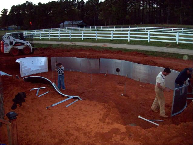

    Thanks Melt in the sun. I just needed to raise it somewhat up to the deck level because of the slope of our yard. I'm having trouble uploading pictures (256k max and I can't get the Photobucket link to take in the file upload box?)
    Good progress today, we got the pool hole dug (except for the deeper middle part). The dirt is working out well to fill around the pool and raise the overall ground level. looks like we won't need to backfill against the house or use any retaining walls. Thanks to Scott, an excellent grading contractor.
    Starting to set wall the panels. Learned it is important to be very accurate with the stake out measurements. The errors will multiply.

    18 x 36 Deer Creek day 3; Learned many lessons that the PBs already know. We had to back up and re-set many of the wall panels. My original layout was just sloppy. I had used a 3' piece 3/4 emt pipe to stake out for the radiii measurements and it would flex a bit when you pulled a tape from it. My first steel check measurements were up to 3" off.
    We then used a short wooden stake with a finish nail and this proved to be an accurate way to lay out. Must have measured, shifted panels and measured 200 times. I finally got smart enough to take a sharpie and write the steel check measurements on the corresponding panels. I think my helper had the 20 measurements all memorized before we finished. A free form pool is definitely a bit tricky for first timers, and the directions were mainly aimed at rectangular shaped designs.. We finally got every measurement within 1/4" and most spot on. Anything better would have required manufacturing the steel to a tighter tolerance.
    We're going to get some serious thunderstorms tonight so we called it a day early and just cleaned up. Tomorrow if it clears and dries enough we will pull out one panel and bring in the Bobcat to finish digging the play pool depth.

    Day 9, not much progress this weekend, I'm just lining up the next phases.
    A nice local PB stopped by yesterday evening to bid on the vermiculite. (From what I had read here this is a job sometimes better left subbed out). His brother does the floors and will stop by Monday for a firm bid. If he comes in with a reasonable price, he can have it. I don't have many days off this month and would love to protect the clay bottom with vermiculite and a liner so it doesn't get eroded with rain.
    This PB did say there was no hurry, he normally does the bottoms almost last after plumbing and backfilling.
    I would rather get it in sooner if possible.
    Monday I plan to bring in #57 stone and backfill under the steps, and add about 1 foot of dirt around the rest of the wall to make a level trench for the plumbing to the equipment pad.
    This PB recommended I run the plumbing down to the footing and stay on the concrete. I would agree except, I did not smooth out the footing at all and it has some rough and ragged parts.
    He says that is preferable to putting pipe on fill, and that most plumbing problems he fixes could be attributed to improperly supporting the piping.
    I have a jumping jack on site and can make that 1' of clay fill as solid as a rock. Unless you experienced guys can talk me out of it, I will fill 1 foot up. This will also keep the skimmer and spa pipes level all the way to the equip pad.
    Attached Images Attached Images
