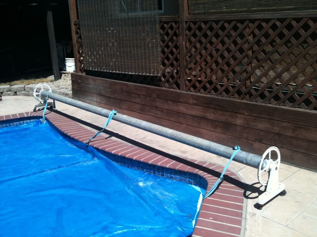

    hi,
    I cannot find a make/model anywhere on it.
    I will attach a photo when I get a chance.
    there is only 1 screw on each side of the reel.
    thanks again,

    Re: solar cover reel is very hard to turn
    If I had that unit, I would take a wrench (or socket) and remove the bolt. With a little help the stand-ends should pull away from the wheel/tube assembly.
    Should then be easy to see if it's a sleeve bearing (use some wheel bearing grease) or a ball/roller bearing. For the latter you may be able to push in some grease and maybe not - depends on the style. And if the bearing is screwed up your best bet might be a local well-equipped Hardware store.
