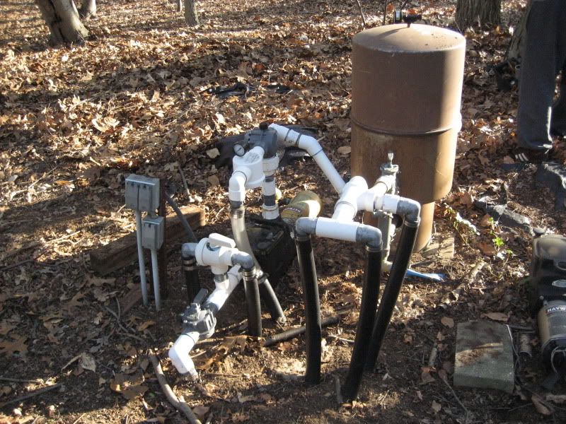

    If you haven't seen it, I have a thread going in the Getting Started forum about opening my pool, Converting swamp to pool. To summarize, I have a ~38,000 gallon pool that has been neglected for 3 years. It has tons of debris, a ~20 year old DE filter, and old vinyl liner. I've gotten some help from that thread on getting the pool cleaned up, but I've run into a problem with my filter so I'd like to get a recommendation from the experts here.
    When adding DE into the skimmer today I noticed it shooting back into the pool through one of the jets. I opened up the filter and saw several tears in the fabric of the grids. Guy at the pool store said I would probably have to replace the grids or get a new filter, but he said if I wanted to save money I could try sewing the tears and covering them with super glue. I did that, but the DE is still coming back in the pool.
    I have a 2hp pump, 1.5" piping with 2 skimmer intakes and 1 main drain, and a 38 sq ft DE filter. I can either get new grids for the filter for $150, or I can get a new filter. So my question, is the 38 sq ft filter big enough for my set-up? If it is, then I will just get the new filter grid. If not, should I get a 48 sq ft or 60 sq ft filter? I tried reading the sticky but I'm a bit confused. I'm thinking that my piping and filter are undersized for the size of the pump and the pool. Any help is very appreciated.
    Here's my setup:
    20'x40' 40,000 gallon leafy swamp, 1980's vinyl, 2 hp Hayward pump, ancient DE filter

    Thanks for the advice. I opened up my backwash valve this morning and noticed the o-rings in there were messed up. I fixed them and that seems to have stopped the de from coming back into the pool. Hopefully I'll be able to use it for few more months before it finally dies. I'm planning on shocking today now that my filter is working.
