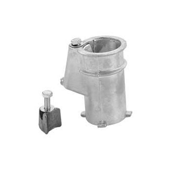

    Here's the only image I can find, but I'm not sure it clarifies anything. It's the most common type used around here. Knowing how they work, I can see it, but you may not
    The bolt and wedge on the left are what is actually in the bulge on the left side of the anchor where the bolt is. When the bolt is loose, the wedge goes down into the bulge, which is wider at the bottom, so it takes the pressure off the ladder. Tightening the bolt pulls the wedge upward which squuezes on the ladder rail. Since tightening the bolt wedges the wedge between the anchor and the ladder rail, you usually have to tap the bolt head to realease the wedge.
