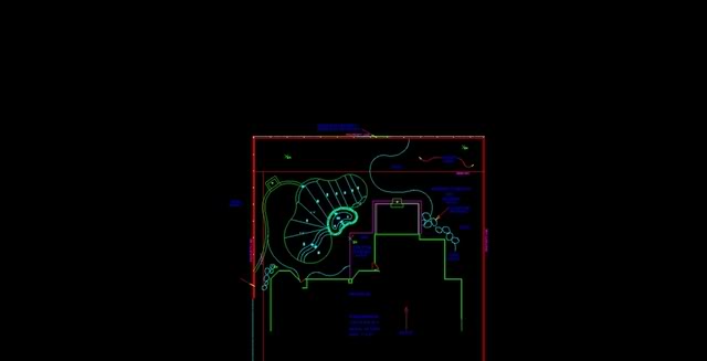

    Here is my autocad working drawing that I use for layout points etc.

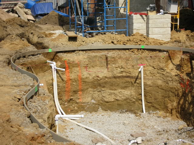

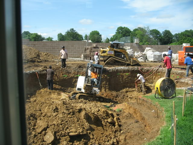

    Here are a few shots of excavation, My 13 Year old is pretty good on a Loader and Track Hoe these days.
    We got about 2 Feet Deep and Hit Sandstone, about 3 feet came out pretty easy but it got really solid after that
    so we have used a Loader, Track Hoe and Jack Hammers to get the excavation done.
    If I had a pool contractor the rock clause would have been a budget breaker.

    This is my 13 year Old Running some equipment.

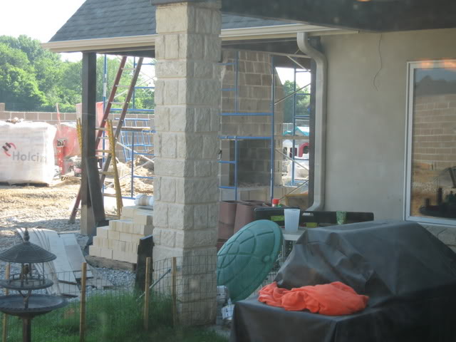

    Part of the new Porch / Fireplace area.

    Finally Time for an Update, Pool is finally completely dug and trimmed as needed for Plumbing & Re bar. We started the Plumbing today, Ditches and piles of dirt everywhere, Its really hard to get around in the back yard but in a couple of days we should get it all covered and leveled back out.

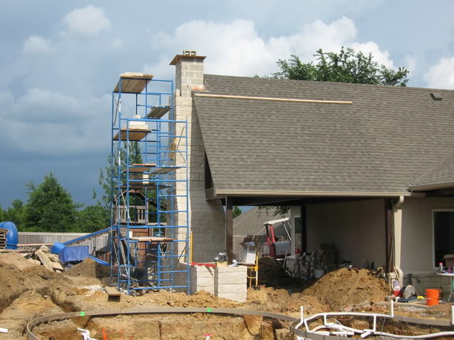

    Today we got most of the returns, Most of the Spa Jets and Suction Lines and the Waterfall Suction and Supply's. Still lots of plumbing to do for the Wall Jets, Bubbler's, Cleaner, Etc and all the electric and control wiring conduit for the automation and lights.
    The First Fireplace is almost done.
    The plan is to finish Plumbing and Re Bar this coming week and be ready for Gunite.
    More pictures on the photo bucket site.

    I have talented employees, My wife and I come up with the designs I do the drawings and layout and It all comes together in the end.
    The porch beams are regular dimensional lumber wrapped with smooth cedar then distressed with a power plane, belt Sander etc to get the hand hewn look.
    The main thing I see right now that has to be fixed is the crooked stone above the Keystone in the center of the fireplace arch, I don't know how that slipped by it really jumps out at me now that I noticed it.
