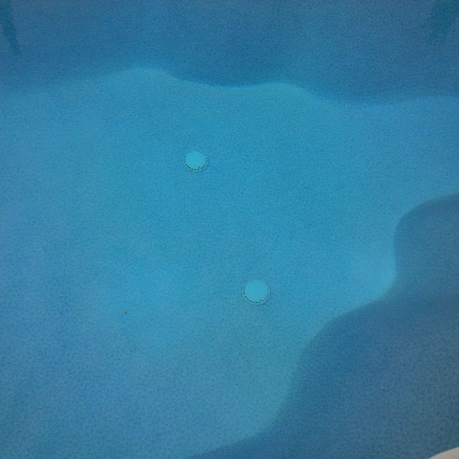

I've brought the pool back up to slam and will check twice more tonight to keep it there do another oclt. Did another brush and vacuum
Water is clear and looking amazing
