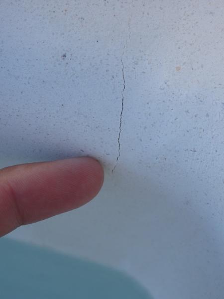

Ok, now then, in the spa, there are CRACKS in the plaster... the spa is filled now, and I shot these before it was filled (which we've done exactly as instructed)... I'm curious on your thoughts-
I noticed this in the bottom of the spa when I first started filling it... and then this when it reached the seat... hairline spider threads of discoloration suggesting cracks wetting before the surface? Is this normal? I didn't see it in the pool... at least didn't notice it.
Upon closer inspection around the wall that was yet submerged, I noticed several cracks in the plaster... is this normal?
Around one of the jets.
Please help me out if you can... I'm very concerned about these things... though, it's likely just the lack of sleep...
