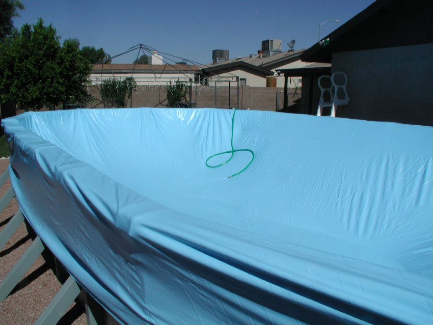

    The first photo shows the liner stretched in using the retaining rods for support. The second photo shows an overlap liner stretched in over the framework of the pool, the preferred method.
    Let us know what parts of the process you need more information on and I am sure we could help.

    So you stretch the liner over the assembled pool, should the liner just touch the bottom of the pool or be suspended? When do you start taking the pool a part and install the coping? When the water is up the wall a few inches and has set the liner in the bottom of the pool?

    Re: Tips for installing an overlap liner?
    Sorry that photo is so big, I'll work on getting a smaller one up there.
    Good questions. The liner should be a few inches off the base before you start the water. The liner will need to be let down as the water puts pressure on it. When the water is just a few inches from the side the hose should be shut off. Take just a few rails off at a time and pull the liner over. I tuck all the excess back into the pool so just an even 2" is showing on the outside. The liner should be pulled up snug so that when you start filling again the the sides smooth out for a nice snug fit.
    Be sure there are no sharp edges on your top rails or caps, if so use lots of duct tape.
