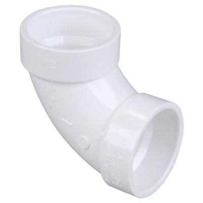

    When using fittings, use this type which is rated for pressure...
    Not this type which is not rated for pressure...
    Don't forget the primer before the glue. A trick to make the job look neat and clean is to put a wrap of masking tape around the pipe about 3/4" away from the end before you put the purple primer on. It looks neat and clean that way and not like someone slaughtered a Smurf.

    Note most sweep elbows are DWV drain fitting, not pressure fittings, so only have half the contact area for the glue joint
