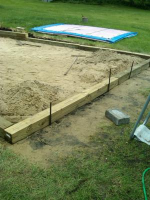

    First, empty and take down the pool. Put it off to the side.
    build a frame around the outside of where the pool will be placed, using 2x4 or 4x4 pressure-treated lumber - Square, octogonal, whatever. Anchor this frame every couple feet to the concrete (many ways to do this).
    Now fill the frame with pool sand and compact it, making the top of the sand level. This is the new base for your pool.
    Wherever you have a post, use a concrete paving stone or more pressure-treated wood shims to provide a solid support surface that bears on the existing concrete (i.e. remove some sand where the posts fall, replace it with the pavers/wood blocks, then pack the sand back around it)
    kind of like this, but with paver stones at the leg locations
