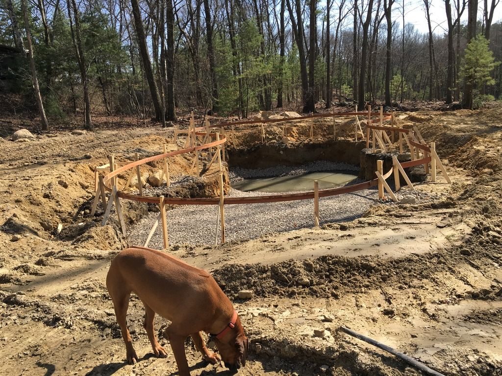

    I'm going to attempt to post some pictures here. Wish me luck!
    The dig is done -- no ledge thank goodness -- a smooth and easy process overall. Here's the shape of the pool.
    Here's the shape of the pool from the back (deep end)

    You did it! I see the pics!
    SWEET!

    Bonnie this is where you get out your tape measure and make sure it is long, wide, deep, short, etc enough in each area. NOW is the time to fix it if it is not. Add about 6 inches for the gunite and plaster.

    So, how do I measure whether everything is as long, wide, deep, short, etc. in each area? I have a regular tape measure, but is there something I should buy that would make doing this easier -- or will a regular tape measure do? I haven't posted pictures yet, but the initial in-pool plumbing is done and gunite is happening either Monday or Tuesday -- so tomorrow is the day for me to measure!

    Pool is coming along nicely. I am curious why you put it so far from the house?

    Boonie you can just use your tape measure that you have. You should have your pool plans. Get that out and see what the plans say it should be. You can also look at each area............do the steps LOOK right? Is the deep end deep enough? Shallow end? Sun shelf-big enough? deep enough?
    PLEASE use GREAT care if you decide to get in to measure.
