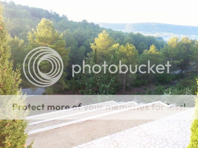

    The site is difficult, steeply sloped with poor access from above for vehicles/machinery.

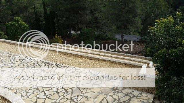

    Here’s how it was in 2008.... So the first job was to terrace the land so it was manageable
    It’s about 50m to the road at the bottom. The builders built a ramp for the machinery to get up the hill from the road. The same will have to be done a second time for the pool machinery to access the 2nd from top terrace where the pool will go. Expensive – should have foreseen this issue when we had the terracing built as the plan was always to have a pool. Hey ho..

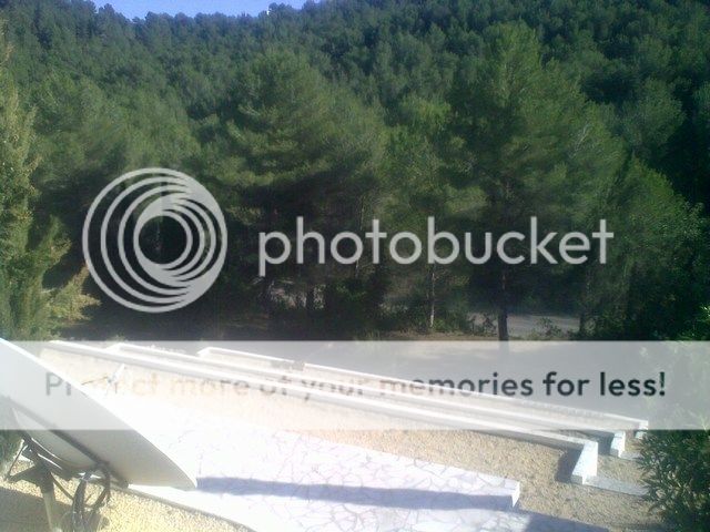

    The pool site.
    Our intention is to use the second level of terracing as the base for the pool. We strongly considered an infinity design as the views might have supported this type of design.
    Long consideration led to the conclusion the site really didn’t justify it. We have a sea view but its limited and infinities work best with open vistas and seascapes (IMHO). The other factors were cost, evaporation and heat loss. Water is a relatively expensive resource in Spain, which combined with the fact that I want to solar heat the pool and use it for extended seasons ruled out this idea.

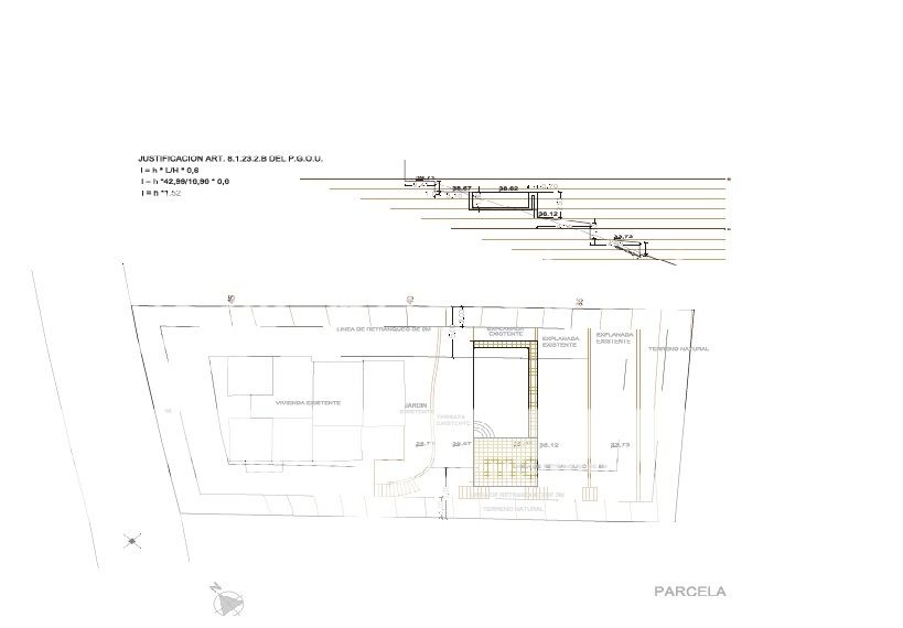

    We don't get the nice 3d graphics over here but I have some plans to share
    Planning permission is a lengthy process in Spain application has been made (a 91 page document) for the relevant permits and approvals. We now wait and hope to start construction in 60 days or so but I have started this thread in case questions arise along the way – as TFP is such a friendly helpful site!
